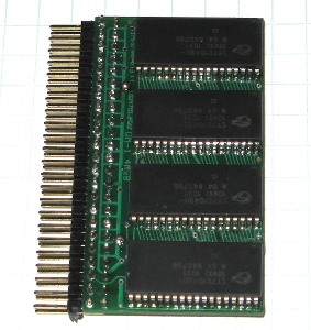

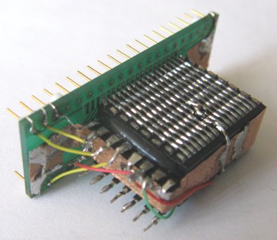

I use SMT for my PCB layouts for work, but I never do connectors in SMT, since I've seen them rip the foils away from the board when any force was put on them. Connectors basically need to be thru-hole because of how that has the effect of riveting them to the board. Thru-hole connectors also take less board space, because they don't have to have wings sticking out the sides.
I have not checked prices recently, but traditionally Ironwood has been three times the price of Aries which gives high quality. One of my early efforts for a multi-megabyte SRAM module was to stack these SRAM ICs on an Aries adapter like this:
Besides not looking nice, this was way too labor-intensive. The PCB I laid out for the moduel I sell stands vertically and takes less area on the board it plugs into:
It has four ICs on each side.
