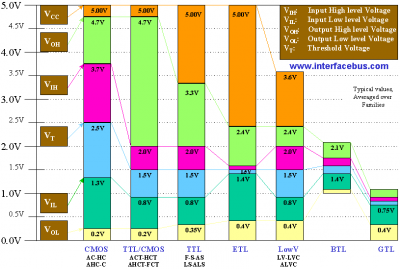

Checking the specs is always a good idea.
Here is a handy chart I came across:
CMOS Vt (theshold voltage) is the highest of the bunch at 2.5V... IH is a little high, but should really work.
