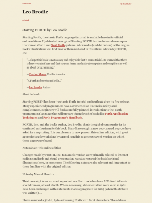

PostPosted: Mon Aug 05, 2013 12:59 pm
BDD, ... you can always turn up the print size on the screen with <Ctrl>+.
Well worth trying - it's the category of "know your tools"! The odd approach you have, BDD, of posting everything with an explicit 110% font size, is a bit wearying.
Also worth trying, for websites which are insufficiently readable, is to read them through http://readability.com - they have a URL-shortener at http://rdd.me, so for example the Forth page is at http://rdd.me/3ndkmk72 - you don't need to sign up, but if not logged in you need to click through to get the readable version. Here's an impression of what it looks like - you can change colour scheme, font size, column width:
File comment: Readability preview
File comment: Original site

I was wondering why BDD's messages are so much clearer! I hope this doesn't turn into a font size contest :)
