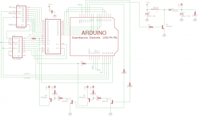

Heck yeah, I'd love to get an updated schematic. It'd be great to be able to program a greater variety of chips. I was looking at the datasheet for the 27C series chips and I didn't see a reasonable way to get the odd voltages it needs during programming.

Ok! I have modified UnaClocker's schematic with the transistors for VPP and A9. I also added a simple boost supply; this is not what I used as you can see in my photo, but I think it will work. Next time I order from Digikey I'll get these components to prototype it. The windowed EPROMs seem to also ask for VCC of 6.5V, but I read this is not necessary. In any case my flash EEPROMs only require 5V.
I ordered an Arduino Leonardo, previously I was using a UNO I borrowed from a friend. I think the Leonardo will be a bit faster because it has a virtual com port, and it's cheaper. I realize the sketch will need to be a bit different, I'd guess it could support both with the right changes.
In terms of speed it seems the slowest part is the bit banging of the shift registers, which is no surprise. I looked at the assembly generated from the C code and maybe it could be better, I will look at making it faster.
eeprom_burner.sch.gz [65.56 KiB]
Downloaded 140 times

Excellent work, thanks! I went ahead and linked to that repository from my Tindie listing. I've got 3 of the first batch left, there was certainly a demand for the units. :) If I make some with the new booster circuit design, I'll send you one of those to play with, as well. :)
