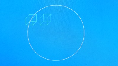

PostPosted: Wed Jul 10, 2013 4:59 pm
Fixed now. Was a delay problem I fixed by shifting the SyncRAM clock and videDAC clock by 315deg.
Now the software sends line coordinates to plot the cube in hardware, sends 3 coordinates to draw the circle in hardware, and copy/pastes a section in software.
The points you see at the very top of the circle and the very left of the circle are the result of removing the multiplication in the algorithm. I put the multiply back.
Now to continue marching towards ellipses.

PostPosted: Wed Jul 10, 2013 9:50 pm
After some more testing, I am suspecting I have an issue that has been around since the beginning of the project.
The pixels are too thick.
It is deceiving because a diagonal line seems smooth as it should be @1024x1024 resolution.
I suspect this because once in awhile during previous testing, erroneous pixels would be present. These pixels would be very small, maybe 1/4 size, hard to tell...
I had attributed the pixel size difference to brightness/color of the pixel, or maybe a fuzzy focus of the monitor.
Now, I don't think this is the case, especially since more testing has been successfully concluded.
My apologies to 8bit, as I used his circle routine and I thought it was the software double plotting. I'm pretty certain it is my hardware.
PostPosted: Fri Jul 12, 2013 1:50 am
ElEctric_EyE wrote:
...I'm pretty certain it is my hardware.
Idiot! The SyncRAM interface module and cpu/blockrom/blockram were all running at 1/2 speed of the videoDAC and SyncRAM clocks, in order to get the read data correctly from the SyncRAM. Of course it's going to get 2 data, also write 2 data per WE pulse from the cpu...
I am back to running the entire system @80MHz pixel clock, it passes synthesis.
As in the past PlotGen module & CPU writing is good . Cpu reading is not correct yet. :evil:
EDIT: BTW, the entire system running @25MHz pixel clk 640x480 is yielding the same results. This is actually encouraging and tells me my Verilog bidirectional interface to the SyncRAM is wrong. I will focus on this interface on the next two days. Need to do some more research on bidirectional Verilog.
