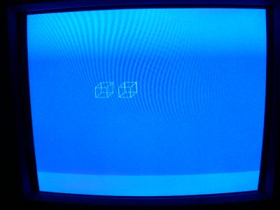

PostPosted: Tue Jul 02, 2013 6:35 am
Of course I can't really quit this project until I have my rotating cube. :wink:
I am off for vacation for a couple days, but here is a pic of a plotted cube on the left, and a copy/pasted cube on the right.
Resolution is 1024x1024 pixel clock @84MHz. Not so square, but that's ok for now.
Also, I managed to program the FPGA PROM much quicker thanks to this tip I had missed before. Setting it to 22 works great. The highest setting of 26 works, but does not auto reset the FPGA.

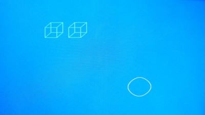

PostPosted: Wed Jul 10, 2013 1:55 pm
Success!
Maybe a register is needed to count the pixels so the cpu can tell me exactly how big of a blockRAM is needed. 2xpixR would just be an approximation.
