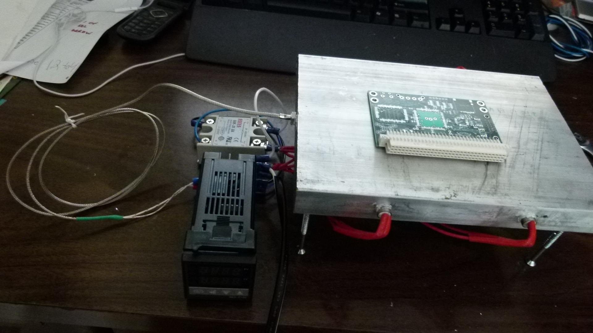

I don't have all the tools needed for tapping holes for the legs, so I drilled holes for some 3" wood screws I had. The holes were .010" smaller than the screw threads and it was still a battle to screw them into the 6061 Al block. I find myself using the micrometer all the time... It's now level and I've finished the wiring of the elements and powered up the PID controller. The 4 300W 120V elements are in parallel and will be wired in series with the 25A SSR. A couple more wires and I fire this baby up and watch the lights dim. :lol: Oh, I still have to drill the TC hole...
One thing I'll be watching is the time it takes to get up to temp. I've tried to outdo you enso! :wink:
PostPosted: Wed Jun 19, 2013 7:42 pm
Ive drilled the TC hole too deep by mistake. Looks like it's over by about .090". I'm going to fill it with some leftover metal shavings and thermal paste. This may be a blessing in disguise as now the PID TC feedback sensor is reading data through similar barriers as the elements.
PostPosted: Wed Jun 19, 2013 7:58 pm
I'm going to drink a beer, recheck the wiring and throw the switch... 120VAC scares the hell out of me!

Hmm, not working... I hear the internal PID controller relay clicking after reset, but no voltage to the SSR. TC is reading correctly and rises in temp to the touch

So I was reading up on this POS PID controller I got from EBAY. I need to modify it. Shouldn't be too difficult. The internal control signals that operate the internal relay need to be brought out to the SSR.
PostPosted: Wed Jun 19, 2013 10:32 pm
So, I made the most rudimentary modification to this PID board, by removing the internal relay and routing the 2 signals offboard, and the SSR is lighting up. Now time to hook up the load. And just 1 more beer...
EDIT:We've got heat! I love modern digital electronics. PID controller, element wires and SSR very cool. Hotplate up to 145deg Celcius. About 1 degree per sec, steady. 8)

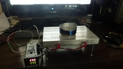

PostPosted: Wed Jun 19, 2013 10:59 pm
SSR getting warmer after 15 mins. Shutting down and putting device on a cookie tray to cool down. Success! Tried to show some steam, it floated to the left of monitor. Legs were getting too warm on the wooden desk. Had to shut down
