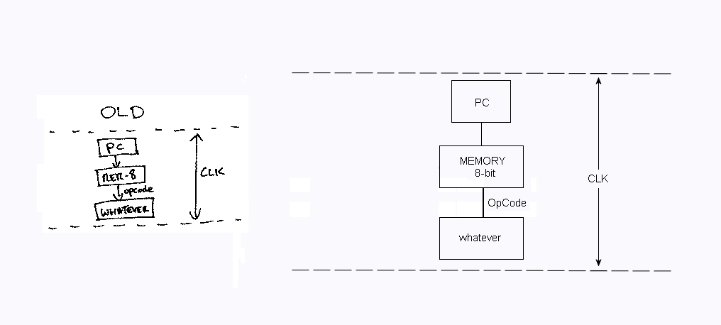

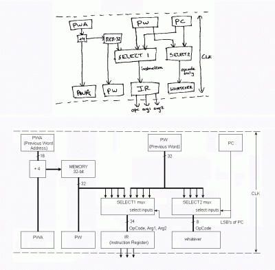

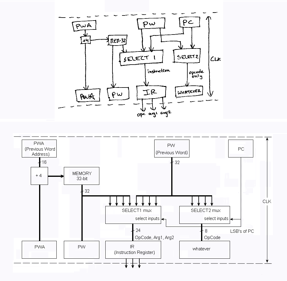

Anyway, following the PM's you & I traded earlier, I created some tidied-up (and more detailed) versions of your diagrams. I hope I've not introduced any distortions.
One thing that bothers me is that the new version seems inconsistent with the quote below. Was it supposed to be? Am I missing something still?
Windfall wrote:
Okay, I see. You've shifted the paths a little by preprocessing the opcode while it's not even registered yet. :shock: :D

In spite of myself, I find myself writing this (OCD). I don't think I or anyone else should withhold information from our community because of bad behaviour of others. The truth is that I've pursued this direction (fast 6502 core with 32-bit RAM) in the past, and abandoned it as too complex a solution. My interest lies more in cycle-compatible retro-machinery anyway, so I am somewhat biased. I will try to stick to the facts and refer to notes from experiments some years back, and to avoid seeing an onslaught of abuse windfall is on my 'foe' list. If windfall posts something useful, please rephrase it in non-judgemental technical language for me.
My initial off-hand dismissal of the idea has to do with the complexity of even the most simple solution, and the fact that the poster has not considered even remotely the consequences of this idea (stated inaptly as 'you are talking out your butt', a regrettable choice of words that no doubt caused much of the escalation. However, that is a pretty good summary of windfall's presentation). As I can't fully rely on my memory, I found notes from several years ago when I pursued this direction extensively, in a misguided effort to create a really fast 8-bit CPU core. I certainly learned a lot, but it was a total waste of time. I sincerely hope that no one here repeats my mistakes.
Jeff's diagram is a nice start, but it doesn't even remotely approach the entirety of the issues at hand. All parts of the 6502 core must be modified and integrated in order for this to actually run at full speed (or at all). Here are some of my notes paraphrased for the occasion.
