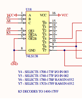

Hi guys,
I'm looking at the I/O decoder logic for the micro-KIM schematic on the hansotten web site and I was wondering if someone could tell me if it's correct, please? With the U18 (74LS138) "A" input tied to VCC wouldn't that activate only the /Y1, /Y3, /Y5, and /Y7 outputs? I've got to be missing something. Can anyone help me out, please?
TIA. Cheerful regards, Mike

With the U18 (74HC138) "A" input tied to VCC wouldn't that activate only the /Y1, /Y3, /Y5, and /Y7 outputs? I've got to be missing something.
No, you're right. It should be the C input that is tied high in order to get the Y4, Y5, Y6, and Y7 outputs.

I did search the Briel forums but I didn't find anything concerning the wiring of U18 (74HC138). Perhaps I missed it. The schematic on the micro-KIM CD seems to show the same wiring for U18 as the schematic on your web site.

Yes, that describes the design error for the "A" input on the 74LS138, which should be connected to A6 instead of VCC...
It's a shame that the "fix" didn't make it into the current schematic...

Sorry about that, that schematic is not the production copy. Here's an updated copy.
http://www.brielcomputers.com/files/MicroKIM25.pdf
