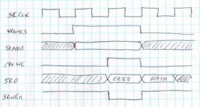

PostPosted: Fri Apr 26, 2013 2:51 am

But, I've been wrestling with a few issues, most of which has been adjusting the design for real world timing for interfacing to an external RAM from FPGA. My early interface attempt I knew was clearly wrong although it worked. So I thought I should post now in order to keep the flow, because I am making progress:

This code results is good plotting believe it or not. In ISim the waveforms look like:
PostPosted: Fri Apr 26, 2013 2:59 am
You can see the VRAMCS is going active due to the 'false read' 1 cycle earlier than it should, because it's actually a write for the software doing an indirect indexed Y store to memory. I don't think the 'false read' is the problem because there is going to be a delay of at least one cycle using this RAM, but a faster RAM? Will be nice to correct another problem from the NMOS 6502.
To me this just doesn't look right because it would be writing ZZZZ's to the RAM and not the data which clearly comes 1 cycles after. The write enable strobe should come at the same time as the data is valid I would think?
PostPosted: Fri Apr 26, 2013 5:50 am
No, that's not looking right. It is probably working because the SRWEn signal is delayed in real life, since it's an unconstrained combinatorial output, so there's some overlap.
What you need to do is get rid of the combinatorial outputs to the SRAM (SRaddr and SRWEn), and replace them with registers. If all the signals are registered, you know they'll all switch at the same time (the registers are all in the IOB, with same delay to pad). Of course, this means that these signals will be delayed by a clock cycle (instead of being delayed by some unknown amount).

When writing, everything gets sent at the same time, clock, address, data, we. When reading, the data valid signal is delayed to match the delayed data.

Ah I see that now, 'state' is 1 cycle behind 'next' and the valid signals are testing the 'state'. I'll try to start on it tonight. Also later, I'll have to consider there are 3 possible addresses going to the RAM. By priority, they are from the Line Generator, cpu, and HVSync generator. The data outputted is always from the B Accumulator.

I modified your module. There are several things I did.
Got rid of:
1) The banking
2) Read only channel 1 logic
3) VGA1 state
4) The OE signal is commented out because my RAM has OE tied active low.
Does it look functional?
Instead of running Sims on the module alone, I decided to reconcile my SRAMif module IO signals to your SRAM controller module IO signals, in order to fit your module into my project.
EDIT: Also, the structure of your state machine is a little different from the one I adapted from the orsoc opencores project. I'm going to try to redo my Line Generator module using that structure and observe any differences in resources used.

PostPosted: Sun Apr 28, 2013 6:30 am
Looks reasonable at first sight, but why did you get rid of the second channel ? I assume you also need multiple channels for your CPU, VGA and line generator. How are you planning to attach those to the SRAM ?
PostPosted: Sun Apr 28, 2013 9:05 am
Arlet wrote:
Looks reasonable at first sight, but why did you get rid of the second channel ?...
The read only VGA1 channel seemed to have priority over all the other states, since it is tested first. This was a conflict in the way I thought my system should work.
Arlet wrote:
... I assume you also need multiple channels for your CPU, VGA and line generator. How are you planning to attach those to the SRAM ?
I was thinking of an address MUX for the WRITE1 state for the Line Generator and cpu and another address MUX for the READ1 state for the cpu and HVSync generator. I'll probably have to add more states to correctly do this, but I just wanted to at least get the cpu writing to the RAM correctly first with the smallest amount of hardware in the way.
EDIT: Maybe I should put the read only channel back in for the HVSync generator, but just give it last priority. What channel did you use to get the pixel counter out to the RAM?
PostPosted: Sun Apr 28, 2013 9:33 am
The advantage of having multiple channels in the SRAM module is that you can prioritize traffic, but also optimize read/write actions. For instance, going from read -> write needs a dummy cycle to avoid bus conflicts, but going from read -> read doesn't. By putting all the decisions in one module, you can balance the priorities better. But there are also other ways to solve this. You could have one read channel and one write channel in the SRAM module, and provide priority indication with your read/write enables (0=no read request, 1 = read request priority 1, 2 = read request priority 2, ...and so on). The SRAM state machine would then switch from read -> write if the write was higher priority, but stay in read mode if it wasn't.
I figure VGA needs a high priority, since it is has the real time requirements to keep the output going. An underrun on your pixel output will result in bad video output. For the CPU/line drawing it doesn't really matter if they are delayed a little bit.
Note that in my state machine, there are no write bursts, forcing the WE# to be deasserted after every write. I assume your syncram will also allow write bursts.
