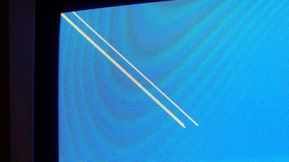

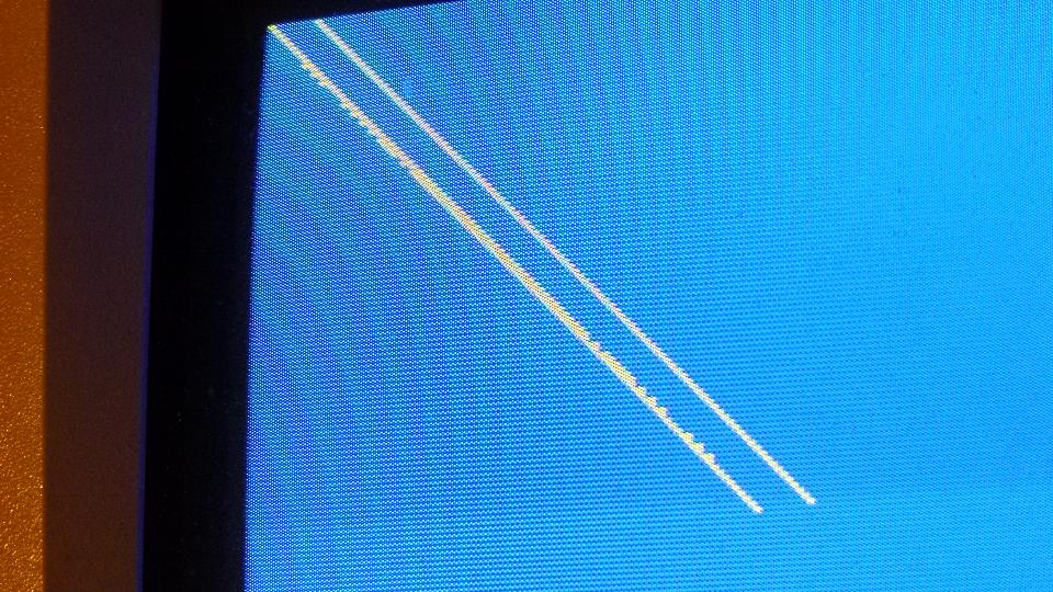

PostPosted: Tue Apr 09, 2013 12:23 pm
This pic more clearly shows the problem I'm having.
The coordinates of the line on the left is (0,0) to (100,101). The other is (10,0) to (110,100). Is this the correct action of your algorithm?
EDIT: I should've pointed out that this is the version 'E' with the DX&DY optimizations commented out.
Interesting, I just uncommented the optimizations. The second pic is the 1 optimization that was fastest. Same result with the other 2 optimizations.
