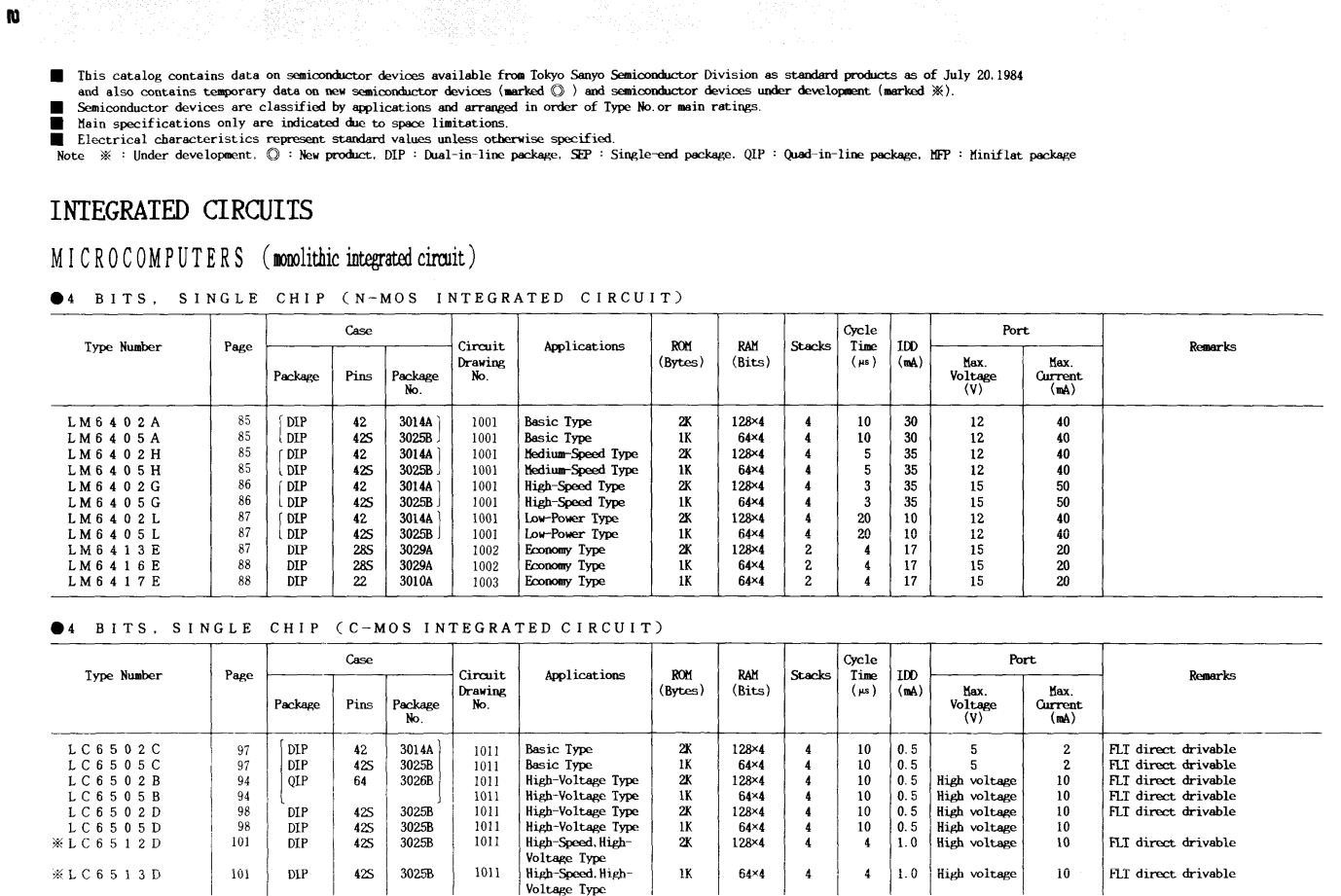

any way this is what I am looking at, it bis a Marantz stereo Amp, and when I opened to examine it, I was quite disappointing when i saw it has a processor driven system, these cannot be repaired easily unless you could replace faulty chips and download firmware, again not an easy task on some products, there are no ports on the rear of this amp where you could connect its embedded micro-controller and re-program it,
Mrantz must have got these chips programmed by the chip manufacturer, before soldering them onto the mother board.
I actually ordered a 42 pin Chip available on Ebay from USA, the guy said it should work as any firmware must still be stored in its internal ROM, the chip cost me $15.00 and the guy wanted another $38 for shipping just a small chip via UPS! I asked him to ship it using just an Air Mial and it should get to me ina few days, but he refused, so I used a friend in USA to order that for me and he posted it to me, only cost $9.45, but sadly this chip had the word Akai, so i guessed that its firmware would not be compatible, as micro-controller, it is in the instructions that you set inputs and outputs, so it was a futile attempt, and needless to say when i tried it, it failed to work, I really wsn't expecting it to TBh, but now that the chip was here in UK, I have no choice but to try it out!
Oh i forgot to tell you, when i unpacked the chip, i noticed that the guy from USA sent me an Akai LC6505C chip, though his picture and description stated it was an LC6502C, so he would be giving my friend a refund in USA!
and it is on a 0.1" pin spacing, so not only is it nearly 3/4" longer than the one used on my Amp, so i checked on the net if 6505 is similar to 6502, so it appears it is except that 6505 has lower built in memory capacity bot in the ROM and RAM!
Mrantz do not support this 20 year old product! The amplifier model is PM453, built for UK market. I have done the basic checks like 5V power being available at the VCC pins and that the clock is arriving at its clock input pin. but it is frozen solid! with some ports on 1 and others on 0, so just glows randomly.

Ok, talking about this LC6502C which is used for controlling Volume control chip - a TC9177P, and Input selet analouge switch TC9163N, both of these chips require a clock, data, and strobe signals from the 6502 processor, and also an MSM59371 IRS or M59371 OKO chip, this none does the LED bargraph showing where the volume level is at, and other LEDs
it appears that my chip has died, or lost its instructions, or firmware, there are no other RROM anywhere on the circuit diagram, so any program must be stored within the chip I believe, but I could be totally wrong, so why I need your help, is there anything i can do to rescue this brilliant 60Watts RMS per channel class A + B amplifier.

I'm starting to think this LC6502 and LC6505 are Marantz part numbers and not 6502-related processors. The 6502, if you get it in a DIP package, always has 40 pins on .100" centers, and the 6505 only has 28 pins, omitting 4 address pins, NMI\, phase-1 out, sync, 3 N/C's, SO\, and one of the Vss pins. Neither one has any onboard RAM or ROM or I/O. They're just bare processors.

Hi Mike, welcome. I agree with Garth - it looks like the LC6502C is a Sanyo 4-bit microcontroller. They'd make a different version for each customer, most likely. Notice how the RAM is described as 128x4 bits.
I think you're going to need an exact replacement, unless the problem is a flaky clock or reset line.

File comment: Sanyo LC6502C 4-bit microcontroller in a product table
