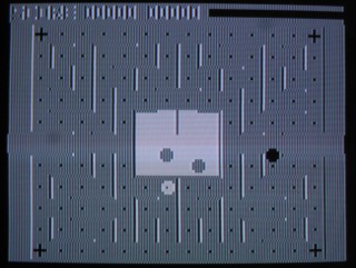

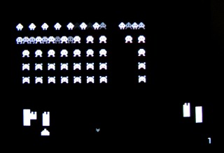

The classic Space Invaders works too, but it's unplayable because it's too fast, running at 8 MHz instead of 1. Some of the other games run at normal speed because they look at the vertical sync, but apparently this one is timed in software. For retro compatibility, I'll have to look into adding an option to slow down the clock.

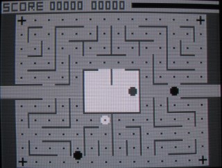

The pac-man clone "snapper" is also too fast, and the screen is messed up because it uses a color mode, and I don't have support for color modes yet.
Added support for the color modes by implementing them as 4 tone grayscale (just random values, so probably not same as original).
