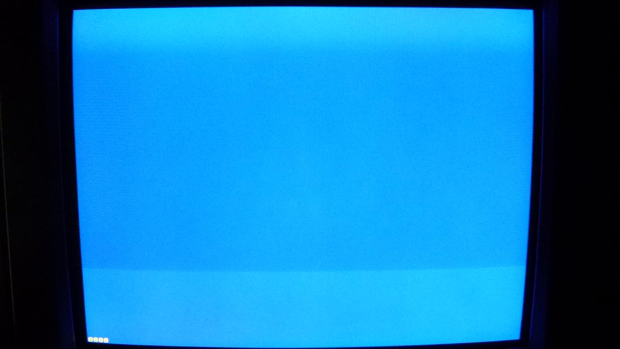

Close, but no cigar tonight. Will add the decimal point, then get the timer tuned in tomorrow.
