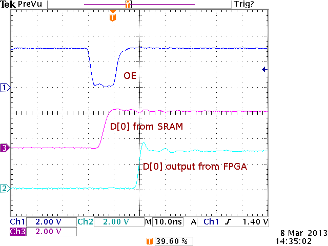

@ElEctric_EyE, another thing to keep in mind is that a lower drive strength reduces instantaneous power consumption by the output drivers when switching multiple output pins at the same time. So, it's better to minimize drive strength, as long as the edges don't become so slow that they mess up the timing. But if you still have, say, 6 ns of timing budget, an extra 1 ns delay from a softer edge won't hurt, but it will help current spikes, and will make optimal bypass cap selection and placement less of an issue.
Of course, we can only control the drive strength of the FPGA, not the SRAM.
By the way, can you explain how you implemented your IODELAY ? I started reading the Xilinx documentation a little better, and started some experiments of my own. For instance, I had assumed there was only an output delay, but I saw that I was wrong about that, and that you can also apply an input delay, or even both input & output delays on the tri-state signals. Given that, an input delay applied to the data signals would seem most appropriate.

Here's a scope image from the SRAM interface. I have an input delay, but based on some experiments, it should be close to zero, so I might as well take it out.
Every division is 10 ns, which is about 1 clock cycle. As you can see, I generate 1 cycle OE pulse (top trace), which results in a edge on a data output D0 from SRAM, after about 6-7 ns, well within the max access time of 10 ns according to datasheet.
On the bottom trace, you can see how the FPGA reads the data, and outputs it on a GPIO pin. Round trip propagation delays from FPGA Q -> SRAM -> FPGA D look like they're about 5 ns, so with a 100 MHz clock, you can grab the data in the middle by just waiting 2 clocks, without any extra IODELAY. It's probably not much different on your board.
