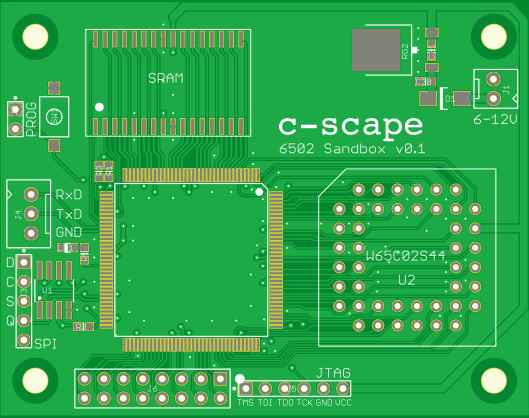

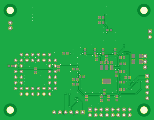

Inspired by enso's 6502 playground, I decided to make something similar myself. The attached pictures are for the first prototype, which has a Spartan-6 FPGA, a 6502 or 65816 in PLCC socket, and an 128kB SRAM device. For I/O there's a simple LED, a UART, and a 16 pin header. Just like in enso's project, all 6502 signals are fed into the FPGA, which sits between the 6502 and the rest of the world. This version is just a prototype to test the concept. I'm planning to make a second version on a slightly bigger board with some more interesting I/O capabilities, such as video, audio and USB. I'm using a SPI serial flash for the FPGA configuration, with the serial pins also brought out to a header. This should allow update of the FPGA contents for people without access to JTAG pods.

Is it a 4-layer board?
How do you have the 3.3V, 2.5V & 1.2V voltages arranged for the FPGA?
No doubt the 6502 and 65816 will be operated at 3.3V?

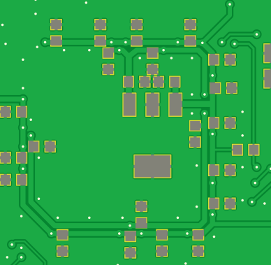

It's a 2 layer board. What you see on the pictures, is what you get. The solid copper areas on top/bottom are ground planes. I'm only using 3.3V and 1.2V. Since VCCaux is also 3.3V, there's no 2.5V net on the board. This also means the 6502 runs at 3.3V. There are no level shifters, and I'm assuming a modern WDC device.
For power distribution, see close up image. There are 2 rings underneath the FPGA. The outer ring is 3.3V, the inner ring is 1.2V. There's a SOT-223 1.2V regulator in the middle, and bypass caps all along both rings. There's one capacitor per power pin, and at least one via near every ground pin connecting to both ground planes. There's a couple 10 uF caps, and a bunch of 100 nF ones.

100nF seems an awfully low value for a power supply pin bypass, like for some circuit running at a very high frequency. Why did you choose this value?
In my project, I anticipated running the same Spartan 6 FPGA using a couple 4.7uF for the 1.2V and 2.5V, 10uF for the 3.3V and plenty of .01uF or .001uF on all the power pins. On the SyncRAM, I made provisions to use .01uF and .001uF on each power pin. These caps are all local to these devices. There are also more of the larger cap's near the main power input connector.
 Post subject: Re: 6502 Sandbox
PostPosted: Fri Mar 01, 2013 5:46 am
100 nF = 0.1 uF, so that's higher than what you are proposing. And there's a couple of 10 uF caps before and after the 1.2V regulator under the FPGA, so they'll also help. I picked 100 nF because that's my standard bypass value, and I have a reel of them in stock.

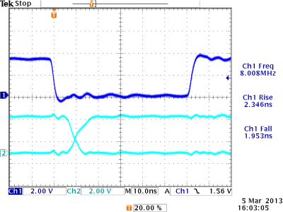

Just got the board in today, and tried it out. FPGA can be configured, and W65C02 is running the famous "NOP" test. I have a 50 MHz oscillator (mounted on GPIO header because I forgot to put it in the schematic :oops:). DCM converts that internally to 96 MHz, which is then divided by 12 to produce an 8 MHz clock for the W65C02.
The W65C02 is cycling through address space executing a fixed NOP instruction. On the scope picture you can see PHI2 input and SYNC output, delayed by about 10 ns.
