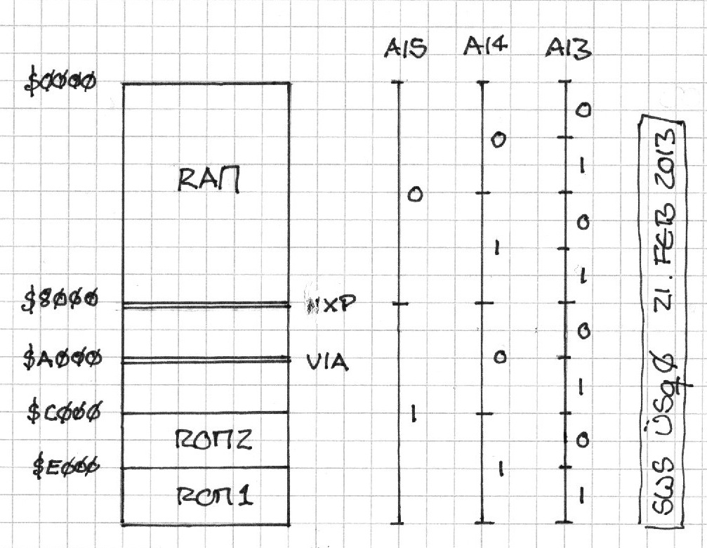

So I think I have my first draft for a memory map and the chip select logic worked out. If I might run it by the group -
Chips: WDC65c02, 62256-80 RAM (32 Kb), NXP 2692A UART, VIA 65c22N, 2 x 28C64-150 EEPROM (each 8 Kb, two distinct chips so one socket can be used as a EEPROM programmer).
Rough map:
0000:7FFF RAM
8000: start of NXP 2692A
A000: start of VIA 65c22N
C000:DFFF ROM 2 (EEPROM socket)
E000:FFFF ROM 1 (Bios, Monitor)
Since we are on 8k segments, the pin table only requires A15, A14, A13, as well as Phi2 for RAM. Ignoring that chip select lines are low for the moment, because it hurts my brain to do both steps at once, that gives us:

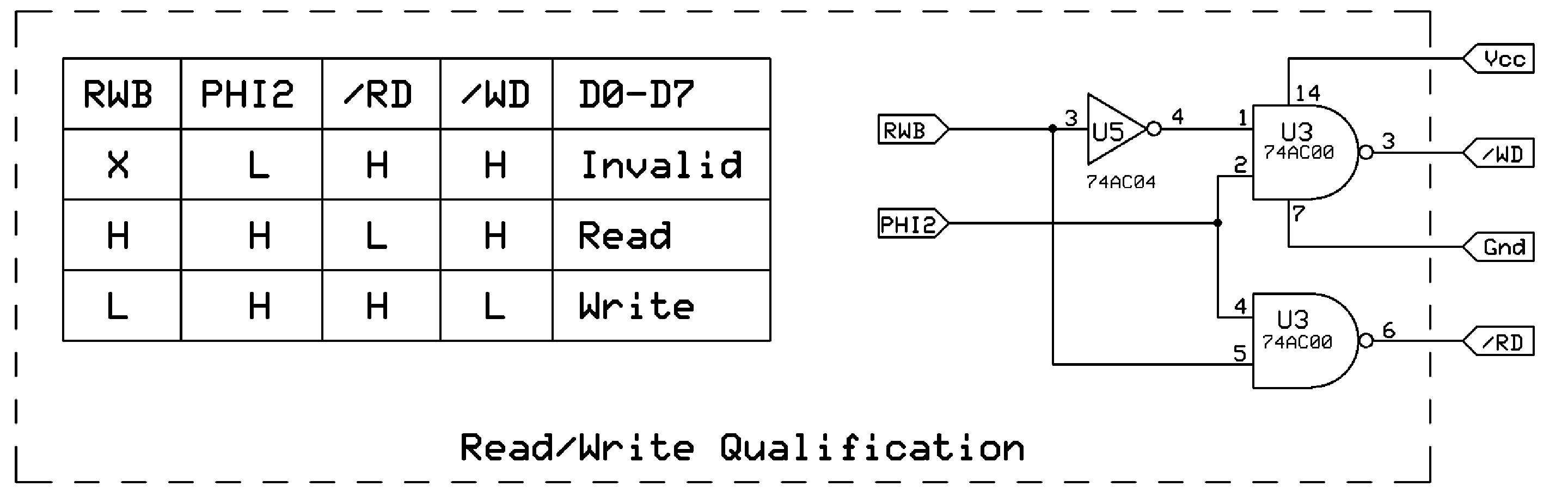

What's Ø2 doing in there? You should not be qualifying decodes with Ø2. Use Ø2 to qualify read/write only. The 65C22, in particular must be selected prior to Ø2 going high. This is clearly spelled out in the timing diagrams. You want your chip selects ready before Ø2 goes high to give the selected device plenty of time to get ready for access. Using Ø2 as a qualifying signal "throws away" valuable time, since the device won't be ready until some time after Ø2 has gone high and the MPU is expecting access to the device.
In the same vein, qualify RWB with Ø2 so /OE (output enable) or /WE (write enable) of the selected device are not asserted when Ø2 is low. Failure to do so with RAM and I/O devices may cause data corruption. See attached schematic.
As for selecting devices, have you looked at the 74AC138 3-8 decoder (data sheet attached)? I think that is all you would need for this application. It has eight low-true outputs that can drive your devices' /CS inputs. BTW, best to use 74AC instead of 74HC logic.

The 65C22N is an open-drain IRQ part designed to replace the old NMOS equivalent. It has current limiting resistors on the output pins. You may wish to consider the 65C22S. However, it has a totem-pole IRQ output, so it will have to be isolated from the rest of the IRQ circuit with Schottky diode, since the 2692 has an open-drain IRQ output.

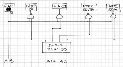

Thanks for the feedback everybody. I'm struggling a bit with timing diagrams, because so far, I could just mentally connect the little black boxes with little black lines. Working on it.
My "local" internet parts supplier only has the AC stuff as SMC, and I'm looking to wirewrap this one -- I have a mild case of essential tremor, so precise work with fiddly small bits can be frustrating, including soldering. Another thing I'm testing with this first project.
I actually have the 74HC237 variant of a 3-to-8 (has a latch) and have been messing around with it. However, wouldn't that just add another station to the RAM selection? I'd have to "catch" the four lines to that segment of of the memory with a four-line AND chip, so I'd have at least two chips in the way. If I just use A15 for the RAM and a 2-to-4 for the rest, that should be a step less for the RAM (see attachment).
That's precisely why I was going to go with the N, it looks easier to handle.
Daryl, thanks for the offer, I've, well, drooled over your whole page there. My idea is do this one the hard way to make sure I actually understand what's going on (work in progress, obviously). The second machine would be one where I'd be looking at all such things. You're bookmarked :-).

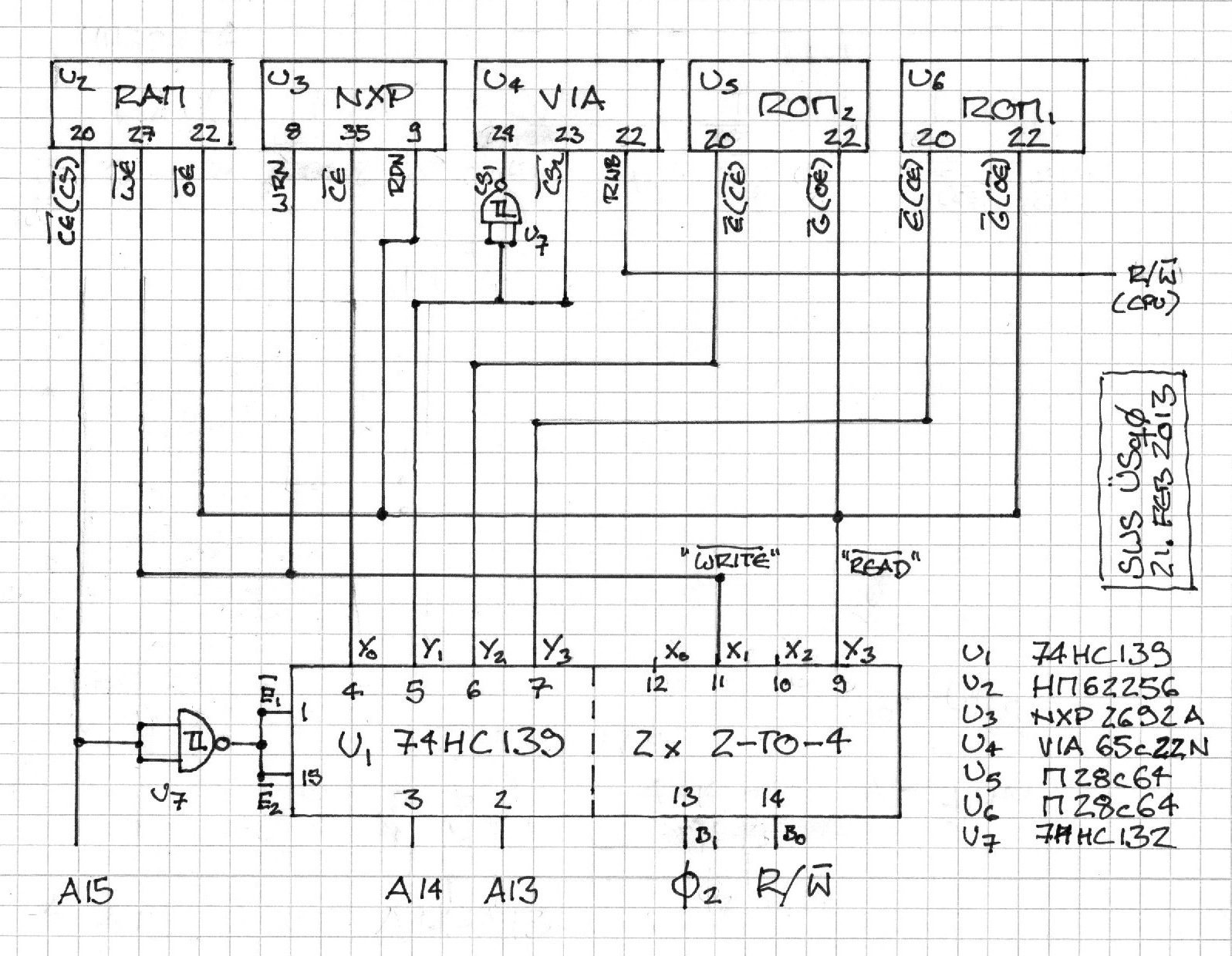

Hi Paul,
PaulF wrote:
You can do what you wish with just 1 74HC139 and a single inverter.
Ay, thanks for all the detail! I won't even post what I had been working on for R/W' and stuff -- mentally, I still have this tendency to try to reduce everything to AND and NOT first before thinking, gee, there is half of a 2-to-4 over here ...
I've included a sketch of how I understood your description (pin numbers need to be re-checked, will do that when I'm fully awake). Don't I need two inverters, a second one on the VIA for CS1 (CS2 is low already)? I connected the R/W' on the VIA directly to the R/W' of the 65c02 as per Garth's tutorial example.
Thanks again. I'll try to get my hands on a '139 next week and breadboard a test.
I haven't been following this very closely so far... but you could tie the CS1 to another address line to narrow down the address range further. Otherwise, you could just tie it high and omit that NAND section. The VIA will only be selected if both chip selects are true. Having the two of them usually makes the glue logic simpler, not more complex.
PostPosted: Thu Feb 21, 2013 1:29 pm
Posts: 143
Location: Brighton, England
I've noticed a mistake on the diagram you posted. Only E1 on the 74HC139 should be connected to the inverted A15. E2 should be connected directly to 0V. You want this section of the 74HC139 to be permanently enabled. As shown, it won't generate READ' and WRITE' signals when A15 is low, so you won't be able to read from or write to RAM!
As Garth Wilson says, you don't need the inverter to drive CS1 on the 65C22. Just tie this pin to +5V
Otherwise, you have correctly interpreted my ramblings. Hope it helps and good luck!

PostPosted: Thu Feb 21, 2013 8:55 pm
Posts: 576
And this is the reason I don't work in a nuclear power plant. Thanks, corrected it and changed the pins as suggested. Including the corrected schematic (and a drawing of the memory map, so it's all in one thread). Both drawings are now taped to the back of my door. Progress was made today, thanks for all the help!
