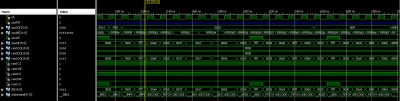

PostPosted: Tue Feb 12, 2013 11:31 am
Signs of life! I had to revert to an older core, the one without the register I/O bus modification, but all the features are still present. I've included the main files to construct a project in ISE. The project file grew to 7MB from older unused data so I chose not to upload that.

Sent you an update. Check PM for a zip with a corrected memory initialization file and the rudimentary test benches I generated.

Thanks for the testbench and finding the error in the .coe file!
The REGFILEINIT.coe file was incorrect for initializing the distributed RAM used for the Acc's, Reg's, Stack, zeropage pointer & stackpage pointer as it had comments I had included, which is not allowed. Now the .b core is functional again with the reg I/O bus.
It's interesting to note that after fixing that file and going back in and adding comments, it doesn't get stuck in the loop even after a cleanup of project files.
But this is good that all this has been straightened out after this 'bug' has been discovered after almost a year of hiding out. Last May 2012 is when Michael suggested the bus and I had put it into action... Updated Github.
