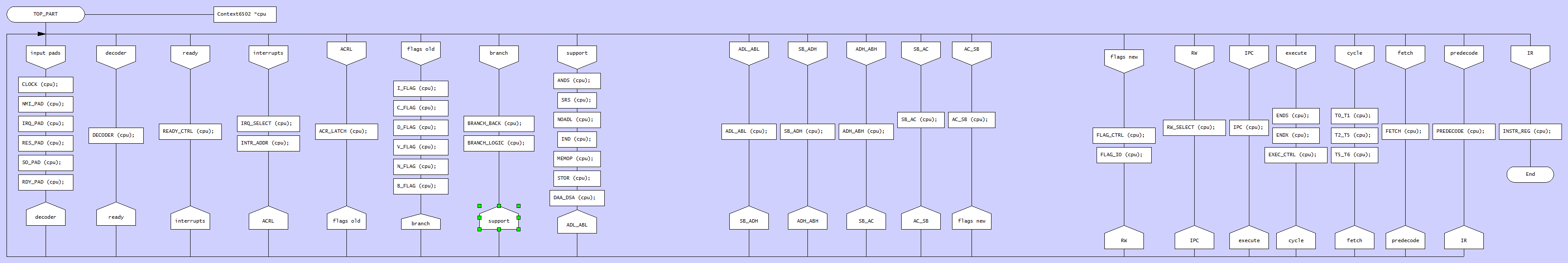

Started to implement 6502 in DRAGON:

Hmm - is that http://en.wikipedia.org/wiki/DRAKON ?
PostPosted: Tue Feb 26, 2013 5:13 am
Posts: 201
Yeah, this one.
I'm using http://drakon-editor.sourceforge.net/ for flowcharts and generate C, as output.
You can get latest drakon-chart on SVN: /breaks/Breaks6502/drakon/

PostPosted: Tue Feb 26, 2013 1:43 pm
Posts: 201
Top part ready :D
