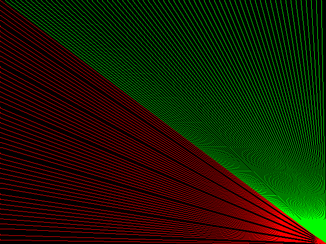

Some progress with Bresenham, but still a few bugs. Only the first frame works, because I don't reset the per-vector state. Also, as you can see in the picture, the red lines have some weird effects on the left side.

Nice progress! How many lines total? ~70?

And they flicker if you scroll the display back and forth quickly.
Pretty cool.
There are spaced every 10 pixels, so 64 green lines and 48 red ones. Maximum for now is 512, because I have a 512x32 bit BRAM for the Bresenham state. That doesn't mean you can display 512 arbitrary vectors. Too many on a single scanline, and the FIFO will underrun.
