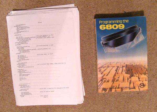

My Weapons (Thrust source code and a 6809 book)
