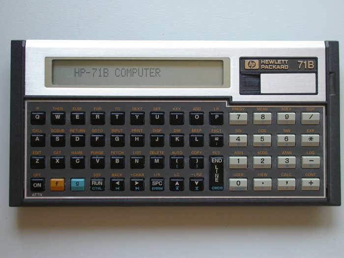

It does look like the width of the keys would have to be slightly sub-standard. The keyboard on my HP-71 handheld computer shown below is about 60% of standard size, and I was able to type on it at about 30wpm, almost 60% of what I can do on a full-sized keyboard. My fingers are pretty slim though.
I typed a lot of notes in meetings, typed memos, letters, etc.. I decided I better quit typing on it so much when they discontinued it. I figured that if I ever wore it out, that's it baby.

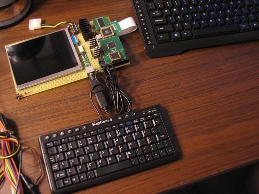

I've not had time to research, but do all the ATTiny series have common opcodes? Can I use the same driver or would I have to experiment?
Got the keyboard in today, so I thought I'd share. It's not as small as the ebay link made it out to be.
Nothing works yet but it looks cool, eh?

if you don`t mind me asking, I`m curious as to Why your using the PS2/USB adapter and not just plugging it in directly to a USB socket?
very few of these adpters are Active devices and are merely pass-through, with D+/D- going directly to Clk and Data, GND/+5V remain the same.
a simple beep test with a continuity meter will confirn this easily, and removes the bulky sticky-outy thing with one less segway for error.

I have a USB keyboard for my SBC, and i have to use the green USB to PS/2 adapter. PS/2 is simple, and mouse as well.

yeah, SBC to PC is pretty easy with the FTDI chips (about £2 on ebay), or even the PIC 18f22k50, 18f2550/4550.
the s/ware I did was the other way around, where it parses a USB Keyboards data into Parallel and Serial output for the SBC to use.
as for the green adapters I`v no idea if they`re different at all, but it would be worth checking with a continuity tester to see if it is just a simple pass-through type.
