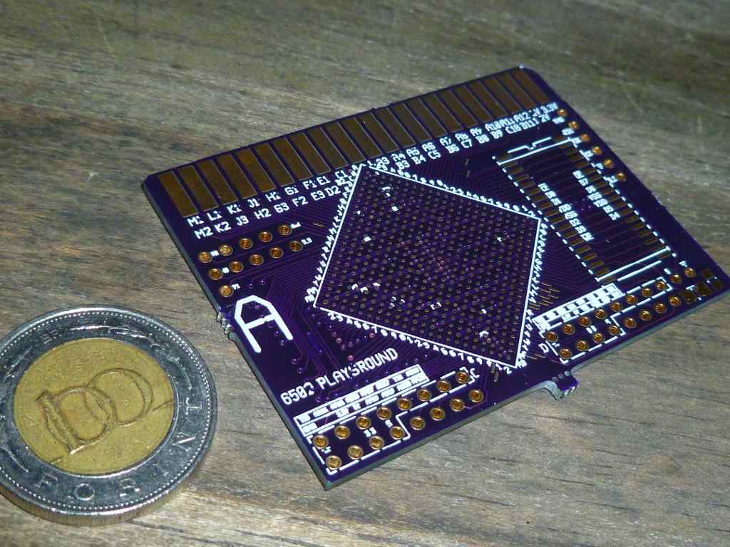

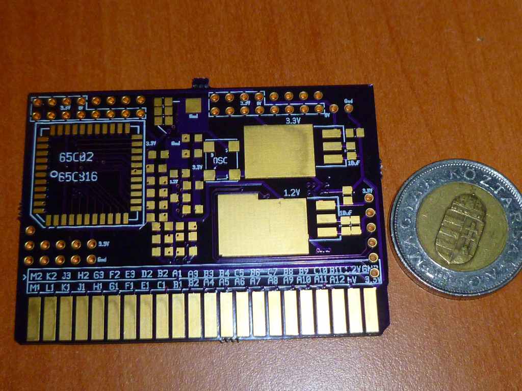

 Post subject: Re: 6502 Playground
PostPosted: Thu Dec 13, 2012 12:58 am
Posts: 904
Finally the first prototype boards came in. A 100 Forint coin is for reference
PostPosted: Sat Feb 09, 2013 11:47 pm
Posts: 904
A family member died tragically and unexpectedly. I've been unable to spend any time on this project.
My hotplate seemed to work well, but the initial board failed to configure - as expected. I created a test board with just JTAG and power connections and a couple of leds. Fabrication was delayed with christmas/new year holidays. I haven't had a chance to try the test board. At this point I can hardly remember what I was doing...
I will try to get back to it. In the meantime if anyone wants the schematics/layout in gEDA format, let me know.
