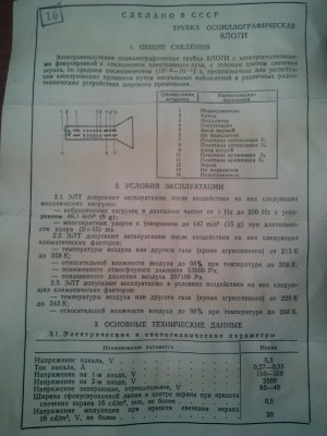

Any Russian speaking folks over here?
I have datasheets of Russian tubes that i bought from ebay, one is for a vfd display, and i managed to figure that one out, but i still didn't manage to get the following one(cheap soviet crt):
I managed to translate the following pins:
1,14 podogrevatelb ?, that would be heating
2 katod, cathode
3 modul?tor ??? modulator
4 oteutetvut ??? missing
5 anod perb?? First anode
6 ne podkl??? not connected
7 ,8 plastina signalvna? y1/2 , probably y axis
9 anod vtoro?, anode something?
10,11 plastina vremenna? x1/2 probably x axis
12 zkran ?, screen
13 ne podkl??? not connected
Further reading of the text just gives mi a headache, since Russian is only vaguely similar to Croatian.
And how this contraption even works, i have 6.3V, 250V and 2000V but how to make it work.
I was hoping to make a terminal like device out of it.
Thanks for any help!

See if the tube type number cross-references to any German, UK or USA types. A lot of Soviet-era tubes were direct copies of standard types produced in the free world. You may get lucky and find an English or German language data sheet.

Wow. Nice puzzle!
Dajgoro wrote:
3 modul?tor ???
This is almost the word "modulator," which is a plausible name for the grid intended to control brightness of the trace.
The diagram on the second page is quite revealing, because it symbolically shows 11 connections and their respective pin connections. ( I wonder why the adjacent chart lists 14 connections?!) Pins 7 & 8 and pins 10 & 11 are the pairs of plates for X and Y deflection (or Y and X; I don't know which is which). Of pins 5, 9 and 12, one will be a focus electrode -- probably 5. The other two I think are accelerator electrodes.

Your guess sounds about right. The voltages suggest electrostatic focus and deflection, so this CRT most likely was intended for use in an oscilloscope or similar instrument.

I am not sure how a Russian would transcribe it, but it would be more or less:
1,14 "Podogrevatel" (the small "b" at the end is not a "b" letter ;) ) - Heater
3 "Modulator"
4 "Otsutstvujet" ??? Need to find my PL-RUS dictionary ;)
5 "Anod pervyj" - First anode
6 "Ne podkluchen" - Not connected
7,8 "Plastina signalnaja" - ok, this would be Y axis
9 "Anod vtoroj" Second anode
10,11 "Plastina vremennaja" - this would be X axis ("vremja" is "time")
12 "Ekran" Shield (?) (at least this is what "ekran" means in Polish)
13 "Ne podkluchen" Not connected
My first electronic playground toy was a Russian "Junnyj Elektronik" :P
[edit] - where I put "j" this would be English "y" - it is the "longer i" ;)

Thanks for helping! Time in Croatian is vrijeme, screen is ekran as well, but i didn't translate that Cyrillic well enough :mrgreen: . I bought the screen to have some fun with it, lcd-s ain't so fun :D.

otsutsvujet is 'missing' or 'not present' according to a native speaking friend.
