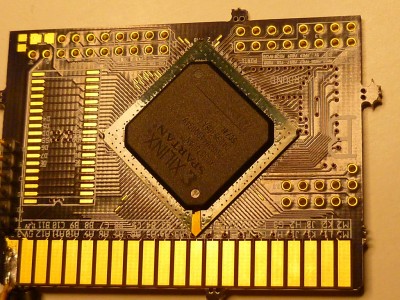

Just mounted a couple of 700ANs using my hotplate. Have a total of 3 now, with a problem:
Current draw: 0.8A from the 5V supply! The chip gets hot (not too hot, just hot enough to be uncomfortable to the touch). This seems just wrong...
Impact identifies the chip correctly.
With the first one, I assumed a BGA mounting issue - a short somewhere... But with 3 behaving the same way, I suspect that I did something stupid, like grounding some pins that should not be grounded...
I am very confident in my ability to solder the 484 pin BGA, at least.
Has anyone had anything like this happen?

Describe more exactly how you're mounting these BGA's, with pics if you can. I am interested in BGA, I will do some research and help if I can.
Re: Spartan-3AN configuration...
-Clean board with alcohol
-Apply liquid flux
-Place the FPGA
-Heat on PID hotplate (latest setting 250C about 30sec. As the balls start melting, a slight slumping occurs)
-Visually verify. Balls have a distinct shape, and I am able to see through every row all the way to the back.
I am pretty certain that the mounting is not the problem as I have 256-pin BGAs working very well.

If you have the 256-pin BGA's working, I would say not only is your mounting technique solid, but also your attention to detail is excellent. There is definately something peculiar to the 484-pin Spartan 3AN device that is different than that of the 256-pin device, or else you made a board design error...
