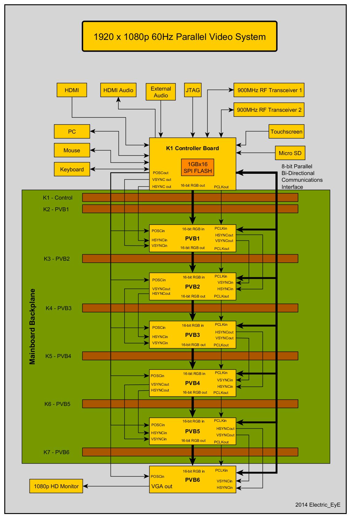

I must confess it has taken me a few weeks after coming up with this idea of parallel computing, even after 99% completion of board design, to wrap my little mind around this design. It is not a simple one. I will tell you all honestly, what gives me confidence is that Arlet has agreed to help develop the HDL for this project. He has shown great skill in the recent past developing sprites with SDRAM timing for v1.1 of the 65Org16 devboard. But this design is totally separate from that one and I'm not calling this project a devboard. Hopefully, some of his hard work will be able to be imported into this design. I believe it will be... My intent here is to concentrate more on the video aspect and change to a more common VGA DB-15 style video output, while maintaining a 3.8"x2.5" board space...

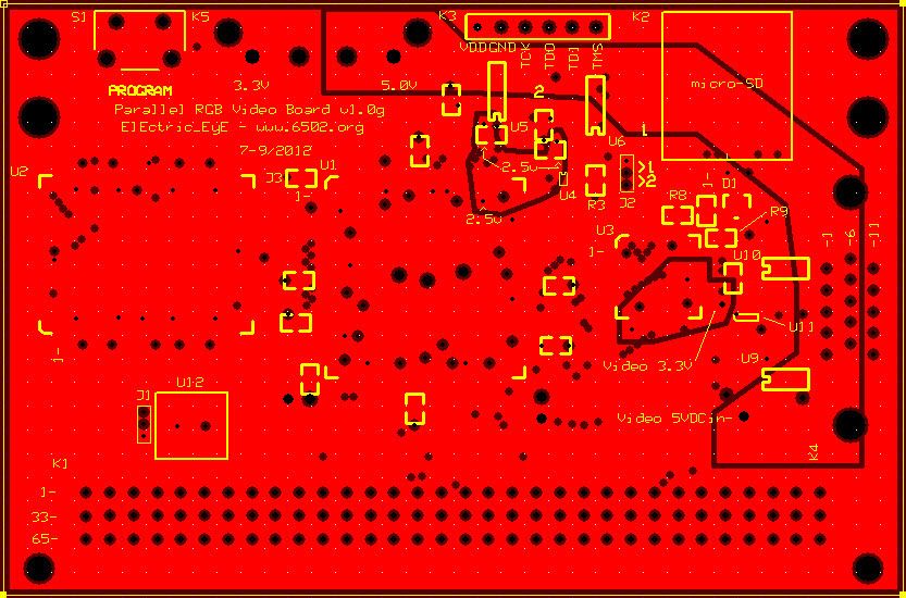

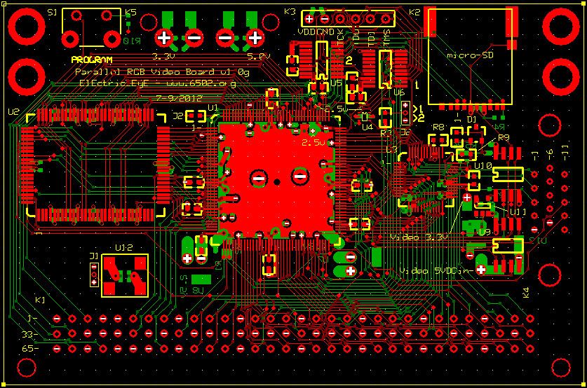

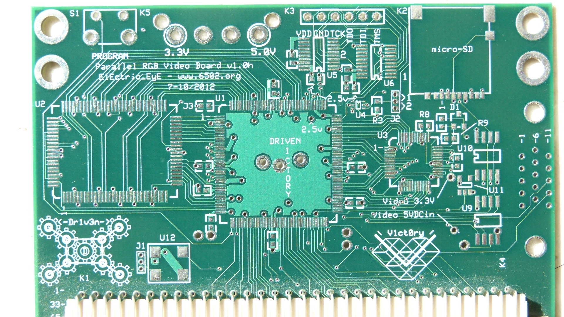

This is the board layout, as it is now. Complete, unless a suggestion is made to improve it in some way. In another thread some people like Garth and Arlet have made important suggestions that I've taken into consideration for the layout of this board. Garth made suggestions regarding the main 96-pin connector GND layout and Arlet suggested a micro-SD card connector and also important suggestions regarding high frequency noise filtering for the videoDAC power supply. Also BigEd encouraged me to continue on a path of mixing video digitally when I started to stray into analog... Thanks all!
Link to CLOSEUP of layout for v1.0g: Original version.
Link to CLOSEUP of layout for v1.0h: Fixed layout errors with U4 MUX. Deleted FPGA control of DACBLANKn. Added FPGA control of SyncRAM ADV/LOADn pin. Also, added 4 momentary push-button switches for debugging/control purposes.
Let me try to explain the concept of the 16-bit design: Each video board has a 2MBx18 synchronous pass-through RAM (16-bits are used for 5-6-5 RGB, 2 parity bits unused...), a 144-pin Spartan 6, a videoDAC, a 3-row 96-pin main connector, and a DB-15 VGA connector for a monitor. The 96-pin main connector allows 16-bit RGB data in, HSYNCin, VSYNCin and PixelClockIn. These signals originate from another video boards' 16-bit RGB data out, HSYNCout, VSYNCout, PixelClockout and are also present on the main connector. The next video board in line can add depth to the video being displayed. Depending on the math, many possibilities exist... It'll be interesting to see how many boards can be successfully cascaded. For now, 4 can fit on another 'in situ' mainboard. We should be able to do preliminary tests in order to verify the design actually works using just 1 standalone video board without the need for a mainboard and controller board.
Looking at the board layout above, I will explain the design starting with U12. A 100MHz (200MHz alt.) oscillator goes to 2 global clocks on 2 separate IOBs on the FPGA, it is expected to divide this clock internally for less jitter. It also goes offboard through the main connector. A jumper (J1) can disable this clock and make its output high impedance. This jumper allows for an outside clock to synchronize multiple boards.
U2 is the 6.5ns pass-through synchronous RAM. 16bits of the databus go to the 4th IOB, top of the S6 (U1). All address lines go to the 1st IOB on the left of the S6. The remaining SyncRAM signals connected to FPGA global clocks are: the main CLK, R/W and ChipSelect.
U5 & U6 are basically 2 XCF04S FPGA PROMs connected in parallel, with standard JTAG connections. iMPACT should be able to see both and either can be programmed. Their serial outputs are multiplexed by U4 (a tinylogic '157 2:1 MUX). It's output goes to the FPGA. The MUX control is a jumpered (J2) resistor (R3), in order to be a pull-up or pull-down. This MUX control also receives a signal from offboard allowing for remote control, hence the resistor. The FPGA /Program signal is also routed offboard. There is also a push button(S1) for manual /Program control.
U9 & U10 are 64Mbit SPI serial FLASH. They each have common dedicated SPI lines, meaning only 1 can be selected at any time. This is done from a S6 /CS signal and U9 inverter.

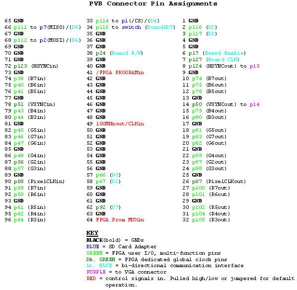

U3 is the videoDAC. 16 signals for 5-6-5 RGB come from IOB3. The video DAC clock and blank signals come from FPGA global clock pins.
The micro-SD adapter has a built in switch when a card is present. This switch signal is present to the S6, letting it know when to use SPI communications. This signal is also output through the main connector (pin34), consider it a "Board Ready" signal. The SPI clk input is common to the one used for the serial FLASHs. If no card is present, MISO, MOSI, and CE (of the SD-Card adapter) are instead used as additional signals for an 8-bit parallel interface to control the video board via remote commands. This interface consists of 8 bi-directional data bus, R/W, Board Select and Board Ready previously mentioned. The Board CLK input signal is also present to a globalclock and orignates from a Controller Board. Specifications will need to be hashed out for commands to/from this interface, but these pins are there for development.

Observations: I think we will need very quick parallel 6-bit ALUs that can do add, subtract, logic AND, OR, EOR, no carry needed on a pixel clock to each Red Green Blue databus to the videoDAC. Once the first board does this math/logical operation in as few cycles as possible, it passes the HSYNC,VSYNC, PixelClock, and 16-bit RGB data into the following 'parallel' board. Recognize that the following board does not read this data and put it into it's own RAM. It is the programmers responsibility to program into the videoRAM of each board what each board is meant to output for the total summation effect. But more on the internals later, it still scrambles my mind!. This is Arlet's speciality. But I do intend to continue my learning some Verilog from this project, so be warned of stupid questions!
EDIT: 11/7/2013-... In an attempt to categorize parts of this thread, which has become quite long to some members' chagrin but was not my intention, I will post a 'concentrated minutes' for each page. This will consist of 1 or 2 sentences.
Page 1: Discussions regarding the concept. Simultaneously Switching Output (SSO) problem of FPGAs. HDMI output? Layout and main connector almost done. IO communication dicussion.
Page 2: More discussions on IO. Realization of a backplane design in order to solidify signals on each PVB. Use of GCLKs in FPGA.
Page 3: SyncRAM chosen, parts list completed. First board design .g manufacture order placed. Problems realized. Parts ordered to complete 1 PVB. Version .h started.
Page 4: Pic for tools I used for construct. Closeup of 1.0g board front and back. Pic's of soldering attempts. Initial testing of FPGA and 2xPROMs successful. HSYNC & VSYNC signals successful in Verilog (started Implementation thread). Found faster SyncRAM.
Page 5: Loftier goals of 1900x1080... Arlet adds RDY signal to his core. More PVB version .h info.

EDIT: 8/13/12 - Added Power Plane pic

EDIT: 6/11/13 - Added pic of .h board

EDIT: 12/7/14 - Added System Block Diagram

I've added the constraint file defining pin assignments to the head post. From this info now I will double check my pin choices vs. the board layout for errors.
I already see 1 change I will make to the layout, especially since it is not difficult, and switch Pin95 "FEN12n" (Flash Chip Select) with Pin72 "SO" since SO may perform better on a global clock pin, and the FEN12n is a slow signal. These assignments are at the very bottom of the .ucf file.
Hopefully, I won't be making many more changes though.
EDIT: I have made these changes.
