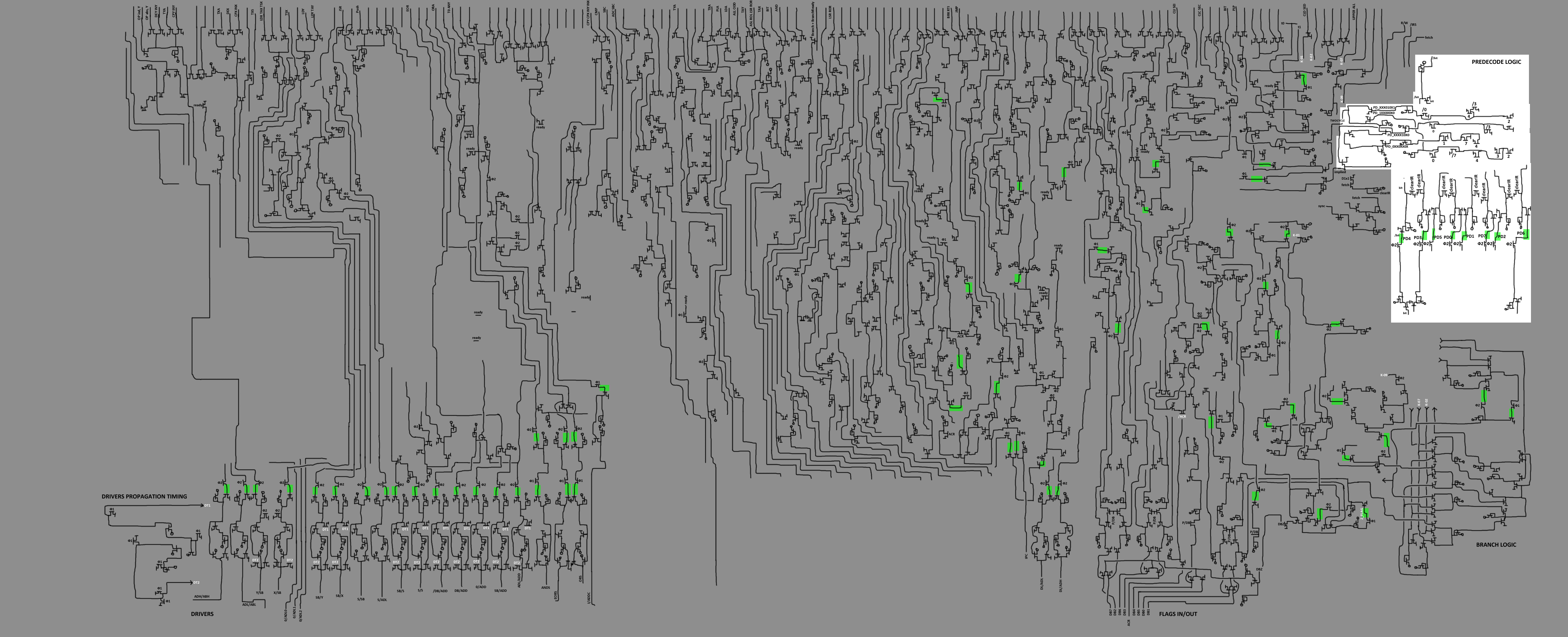

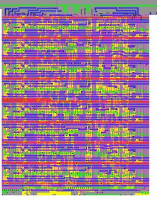

Completed random logic color schematics.
Also I choosed another strategy to reverse this whole crap. I start from T0 only PLA lines, then continue on T1 lines only and so on.

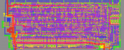

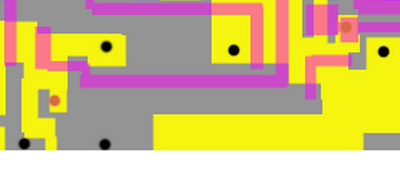

quick progress! But you missed a horizontal run of poly - see pic.
File comment: missing poly - bottom edge of ALU
PostPosted: Fri Jul 13, 2012 7:52 pm
Posts: 201
Ehhehe, damn puzzle :mrgreen:
I'll fix it in transistor level schematics )
EDIT: you don't need this poly line, it somes from from address latch )
EDIT2: ooops, or maybe need )

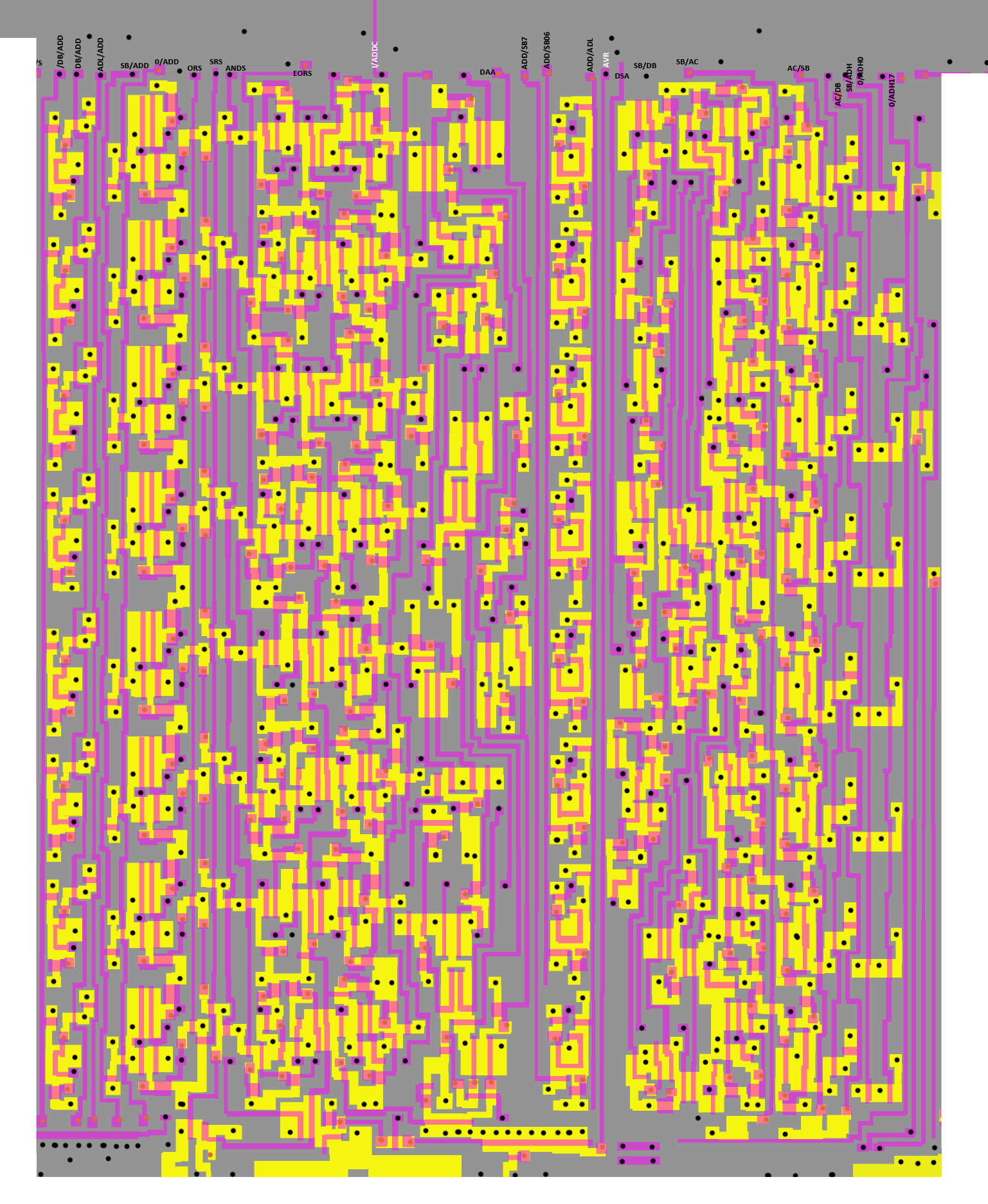

Todays speccy: ALU bit0
Pieces from left-to-right: B INPUT (BI), A INPUT (AI), LOGIC, ARITHMETIC, DECIMAL ADDER, ADDER HOLD REG (ADD), DECIMAL ADJUST, ACCUMULATOR (AC).
6502 addict
PostPosted: Sat Jul 14, 2012 11:36 am
Posts: 10949
Decimal adjust is a big random tangle! It's also not organised by bit slices. Joyful!

More progress on ALU.

PostPosted: Wed Jul 18, 2012 2:25 pm
Posts: 201
More progress on random logic.
I recognized branch processing logic, some flags and their connections with internal data bus.
Missing parts are matter of time.

PostPosted: Thu Jul 19, 2012 8:51 pm
Posts: 201
Todays evening progess on ALU :D
Decimal subtract adjust and accumulator are still missing.
DAA and DSA are really nightmare at first look.....
ALU input drivers :
/DB/ADD (inverted DB -> B input)
DB/ADD (DB -> B input)
ADL/ADD (ADL -> B input)
SB/ADD (SB -> A input)
0/ADD (0 -> A input)
ORS (logical or)
SRS (shift right)
ANDS (logical and)
EORS (logical xor)
I/ADDC (carry in)
SUMS (arithmetic sum)
DAA (decimal addition adjust)
ADD/SB7 (adder result -> SB7)
ADD/SB06 (adder result -> SB0-6)
ADD/ADL (adder result -> ADL)
DSA (decimal subtract adjust)
SB/DB (SB <-> DB)
SB/AC (SB -> accumulator)
AC/SB (accumulator -> SB)
AC/DB (accumulator -> DB)
SB/ADH (SB -> ADH)
0/ADH0 (0 -> ADH0)
0/ADH17 (0 -> ADH1-7)
ALU outputs :
AVR (overflow out)
ACR (carry out)
Making it nice "blackbox" for educational purposes :D
