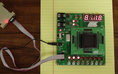

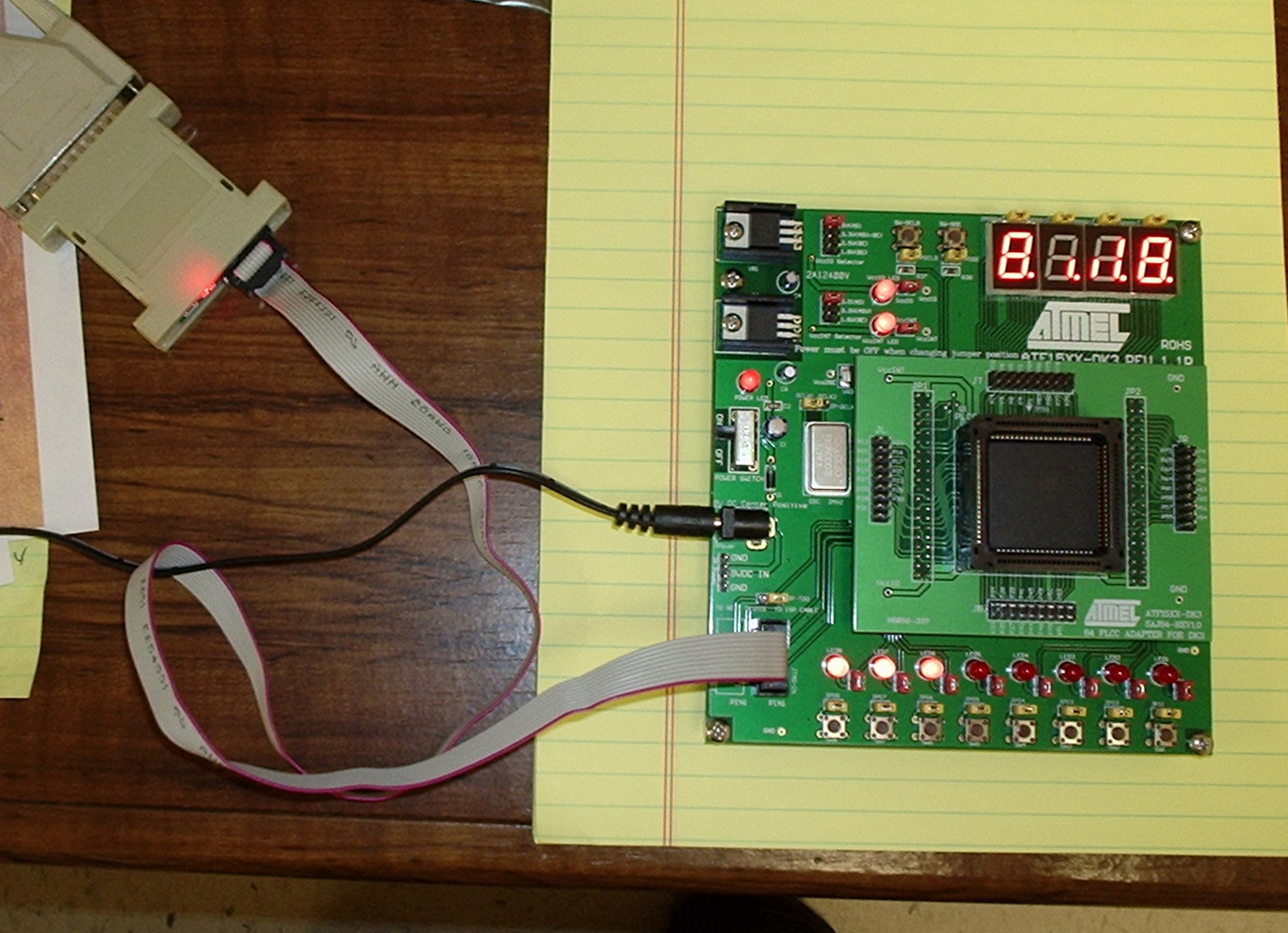

Atmel makes a programmer/tester for their ATF15xx CPLD series, which includes the ATF1508as I plan to use in POC V2. This unit works through a standard Centronics port on a PC and is powered by a 9 volt DC wall wart. Here are some pictures.
File comment: Atmel ATF15XX-DK3 CPLD Programmer/Tester
In the above pictures, I have loaded a test fuse map into an ATF1508as, the purpose of which is to exercise some of the outputs and prove that the CPLD and the test rig are working.

It's a device test rig as well as programmer. If programming is all that is needed a simple JTAG hookup will suffice, like with the Xilinx parts.
I decided to get this unit so I could play around with the logic after written into the CPLD. There are some 7-segment displays, LEDs, push buttons, etc., all of which can be used to see what happens when input X goes high or input Y goes low. There is also an embedded clock generator for testing logic where a clock signal is involved.
Atmel makes different adapters for this unit so various package sizes and types can be supported. The unit ships with a 44 pin PQFP adapter, as well as some sample CPLDs in that package size. The version of the ATF1508as I plan to use comes in a PLCC84 package, so I also got one of those adapters.
