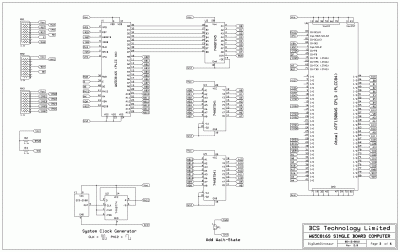

Update: this project is not dead but is undergoing some re-engineering. My original plan was to implement glue logic with an
Atmel ATF2500C CPLD. However, after looking at some of Atmel's other offerings, I now think their
ATF1508AS type is a better (though more expensive) choice and will give me a lot more design flexibility. With many more inputs/outputs, I should be able to work out better memory management, as well as better I/O hardware control. I may even be able to implement hardware memory protection and vectored interrupt handling.
I'm just now getting into studying this device to see how I can best use it. More to follow...

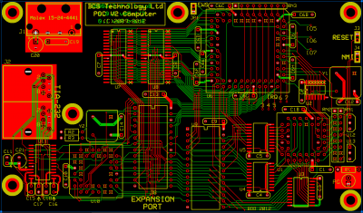

I've been playing around with the
Atmel ATF1508AS in Atmel's WinCUPL software and now have a reasonable understanding of this part. It comes in a PLCC84 package and uses about 1.69 square inches of PCB real estate. Hence when I build POC V2 it won't be on EPCB's Proro-Pro layout, as its 21 square inch maximum size and hole count limit isn't enough for everything. That means I'll have to use EPCB's four-layer production service, which is going to add cost to the finished product. The upside is that the board will be sufficiently large to also contain the SCSI host adapter.

Regardless, this much memory, along with other hardware (e.g., the SCSI controller) is bound to add significant bus loading, necessitating the use of octal bus transceivers to increase the available drive. Fortunately, the 74ABT245 transceiver is available in a small outline (50 mil pin spacing) package, so PCB real estate won't be gobbled up. This is important, as three transceivers are required: one for D0-D7, a second one for A0-A7 and a third for A8-A15.
There also will be some tricky CPLD coding required to produce what I want but I think I can do it.
