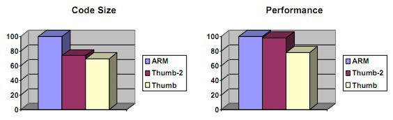

slightly off topic, but here's a pdf describing thumb2, ARM's second attempt to create a compact 16-bit instruction set, which seems to have got significantly better tradeoff of performance versus density:
For example, there's a multi-predication instruction (because there's no room for bits in every instruction) to setup the next four instructions to be conditional in various ways. Not sure how that plays with interrupts.
