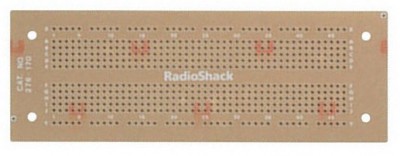

My choice for the last 20 years for analog circuits is the solderable breadboards, primarily the one that is found under various names but Radio Shack sells as p/n 276-170, usually for two or three dollars. It looks like this:
I've used scores of these for various projects over the last couple of decades. In fact you can see two of them in the first picture at http://www.6502.org/users/garth/projects.php?project=1 These two are not particularly good examples of the density you can get with this board; but what I like about it that I don't like about so many others is that this one has five holes in a row connected on each side of the center island where the ICs go, instead of the three that so many others have. It makes a big difference. You can actually do more with these than you can with the solderless breadboard equivalent pattern because A., you can also solder a few parts on the back, B., the holes are big enough that you can do the occasional two-leads-in-one hole trick, and C., you can cut a trace if you need two small nets on that row.
