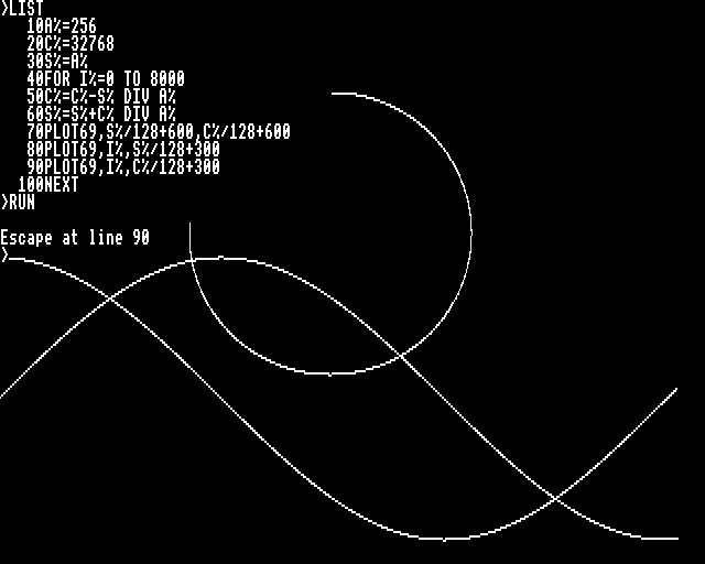

Moving slightly back towards integer arithmetic and plotting of a sine curve, there's an old trick due to Minsky which is a close approximation, and uses only add and shift. In fact, maybe not even a shift because a shift by 8 is just picking off a different byte:
At first this was drawing spirals, but it turned out I was using floating point division: it draws near-circles if integer division is used.
   10 A%=256
   20 C%=32768
   30 S%=A%
   40 FOR I%=0 TO 8000
   50   C%=C%-S% DIV A%
   60   S%=S%+C% DIV A%
   70   PLOT69,S%/128+600,C%/128+600
   80   PLOT69,I%,S%/128+300
   90   PLOT69,I%,C%/128+300
  100   NEXT
(Lots of other interesting tricks in the Hakmem memo.)
