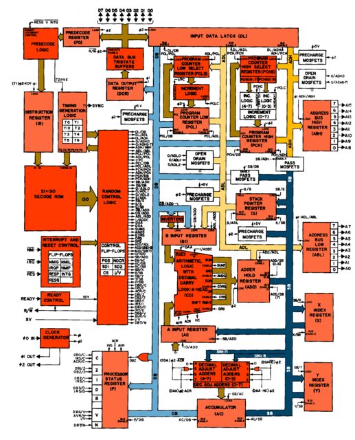

I couldn't find a colorized version of the 6502 Block Diagram. I found it difficult to follow where things like DB and SB go, because they criss-cross with ADL, ADH, and blend in with other lines and blocks. So, I created my own colorized version. I am a tech guy, not an artist, so you'll have to excuse the terrible color scheme:
And here is a link to a slightly sharpened one. That version makes the text a little easier to see, but obviously it has sharpening artifacts.
Let me know if anyone else likes this. Also, I'd greatly appreciate a better color scheme. So feel free to edit what I've made, create your own from scratch, or suggest a new color scheme and I'll be glad to edit my version.

nice!
thank you!
