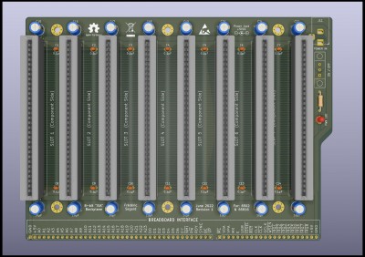

I know it's an old thread, but it's relevant to my current project. I'm in the process of designing a backplane using 62-pin ISA card edge connectors. It gives me plenty of pins to have a 65816 CPU board with all associated signals. I have 8 slots, 22mm on-center, and the total trace length from end to end is below 15cm. On the same board, I'm breaking out the signals to a 62-pin single-row header, so I can plug the backplane board directly on a BB830 breadboard for experimentation.
Trace width from one end of the bus to the other is .45mm. And trace width to the breakout header is .33mm. Power distribution trace width goes from 2.5mm to 1.6mm. It's a 4-layer board, where bus lines and some power distribution traces will be on the front layer, and the perpendicular bus lines to the breakout header are on the back layer. One of the inner layers is a VCC plane, and the other is a ground plane (or should they be both ground planes?). Front and back layers are also ground copper-filled.
After reading this thread, and trying to understand Dr. Johnson's articles (which went over my head, to be honest), I'm wondering if it will be pertinent to implement bus termination (in part because it's a relatively short bus). I plan on running my bus at 8HMz. If all my signals are properly driven with ABT family of chips, should I still consider termination? Do all signals benefit from termination? What seems to be popular is the resistor divider 330Ω-220Ω termination scheme. There's also the 2.85 V regulator with 220Ω series resistors to the signals may also be an option. What about normally pulled-up lines like /IRQ, /NMI, BE, etc?

fredericsegard, no need to apologize for reviving an old topic. It will always be relevant.
See the 6502 primer's page about construction for good AC performance, at http://wilsonminesco.com/6502primer/construction.html . It has good links to lectures and articles about termination; but I also just expanded it to cover the matter of connector pinout, since you only have power and ground at the ends, something that is ok only for slow components.
