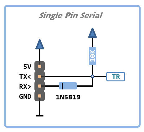

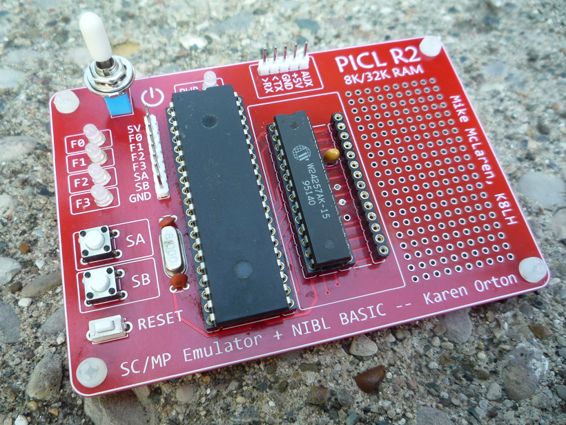

I thought about trying half-duplex serial using a single VIA pin that switches between input and output as required. This method pretty much forces a hardware echo (like the KIM-1). I tried this on my version of Karen Orton's SCMP Emulator + NIBL BASIC and it worked well. As a bonus the diode prevented power back feeding the uC from the usb-serial adapter when the power switch on the board was switched off.
