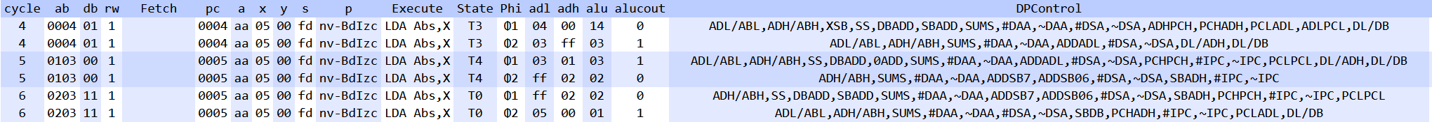

For the ones where T4 is optional, such as LDA/X/Y Absolute Indexed - well, it's pretty easy to understand what's probably happening here I think? During T3 Phi2, if the ALU carry out signal is set, the PLA selects T4, and once the instruction is in T4 the fixup always has to happen, you could say by definition.

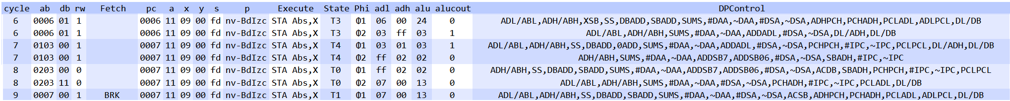

However, T4 always happens for STA, so something else has to determine whether or not ADH is incremented, but I don't quite see how the timing lines up.

My understanding is that by the time ADH/ABH can potentially be latched, the ALU carry out from the previous cycle (T3) will have been replaced with the result from the current one (T4)? As shown in the second picture I've uploaded, alucout is 0 in Phi2 of T4 (cycle 7) of STA Abs X, which is the half-cycle that latches ADH/ABH or not, but the fix up does happen. Furthermore, returning to the first image of LDA Abs X, the situation is reversed - alucout is 0 in T3 Phi1, only being set to 1 in Phi2. But the processor proceeds to T4, so it must be using the Phi2 value in that case (if it is indeed directly using ALU carry out and not an intermediary).
Is the CPU able to use both the Phi1 and Phi2 values from the ALU carry out when deciding on the next data path nodes? Or is there some other signal that's being set somewhere?
