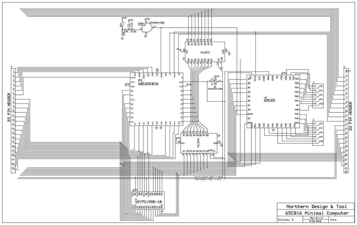

PostPosted: Tue Aug 31, 2010 1:36 am
Joined: Mon Mar 08, 2010 1:01 am
Posts: 142
And there you go, my project became a 65** series project ...
Not done as you can see, going to add the ROM, other unit of RAM, Flash, and glue logic for memory selection in the next couple of days. I hope to fit it all on a 3.8x2.5" double sided 4 layer board.
If you notice that I borrowed one of your designs, thank you cause I did borrow some stuff. :D
Like what you see so far?
PS. All 74 series logic "LS" etc is representative, the I'll be using the fastest version of each IC I can find in a SMD package to cut down on space.
