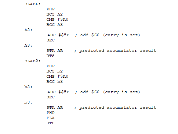

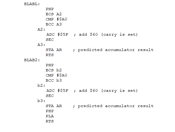

I suggest ignoring at least the first tab character in labels. In my opinion, this would improve the readability of user-generated source code and reduce the number of frustrating errors.

In my opinion, this example source code is more readable, and I can locate important fragments more quickly than
the next one. Especially if it's extensive.
Unfortunately, for the assembler in Kowalski Sym. the first one is unacceptable even though I can create it in its editor,

To my eyes, which have been staring at 6502 assembly language programs for nearly 50 years, it looks like a disorganized mess.  The labels’ offset from the left actually worsens the readability of the instruction statements.  I would find having to read that while debugging a program to be sufficiently annoying to warrant reformatting the listing to get the labels out of the way.
Something that threw me when I first read that was the lack of a blank line between the end of subroutine BLABL and the start of subroutine BLAB2.  It appeared that they were one sub...so much for readability.  After realizing that BLAB2 was not part of BLABL, I noticed that the former has a little bug in it waiting to bite you.  :D
BTW, just about every assembler I have used required that symbols and labels be started in the first column—and these weren’t just 65xx assemblers.  In theory, it should be possible to efface leading whitespace by scanning each source line to find the first non-whitespace character.  However, doing so will add processing overhead, especially when assembling many INCLUDE files, without contributing anything to the overall task of generating code.
If you are looking to indent sections to help visualize program flow in loops, you should only indent the mnemonics, operands and comments.  Garth has some good illustrations of that on his website.  I don’t indent things such as loop bodies in my source, but if I did, I would be using a model such as his.
