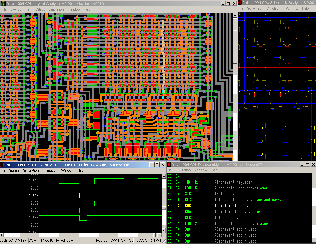

There's also a 4004 simulation by Lajos Kintli (Windows executable) - see this screenshot:

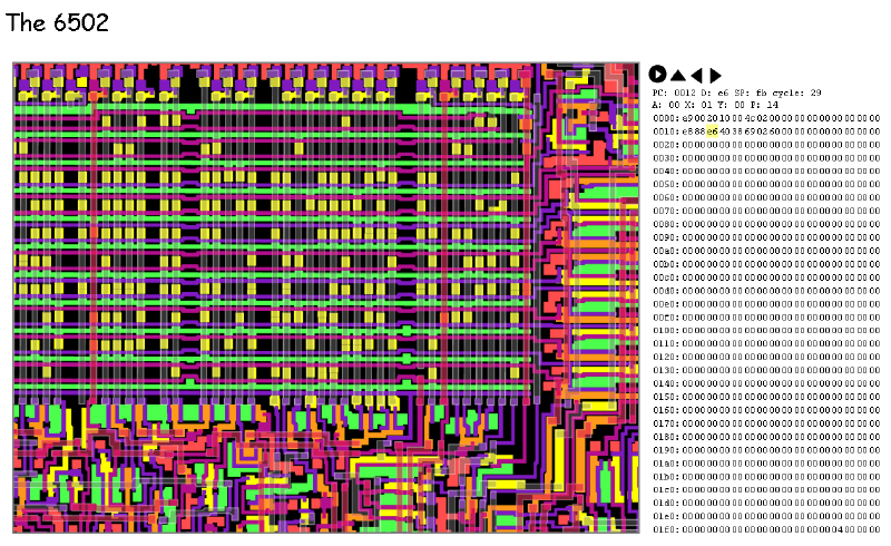

After a long journey which starts with a chip and some sulphuric acid, they've produced a visual simulation of the chip. You can zoom in, single-cycle, probe the circuit for logic levels. It's javascript which means you need a fast browser on a fast machine, and it's a work in progress which means things will only get better. You need a fairly high screen resolution too.
Here's a screenshot looking at a corner of the PLA during simulation:
Its running at about 2Hz.
I've asked Mike to put some of the materials up - the PDF of the presentation is well worth going through.
