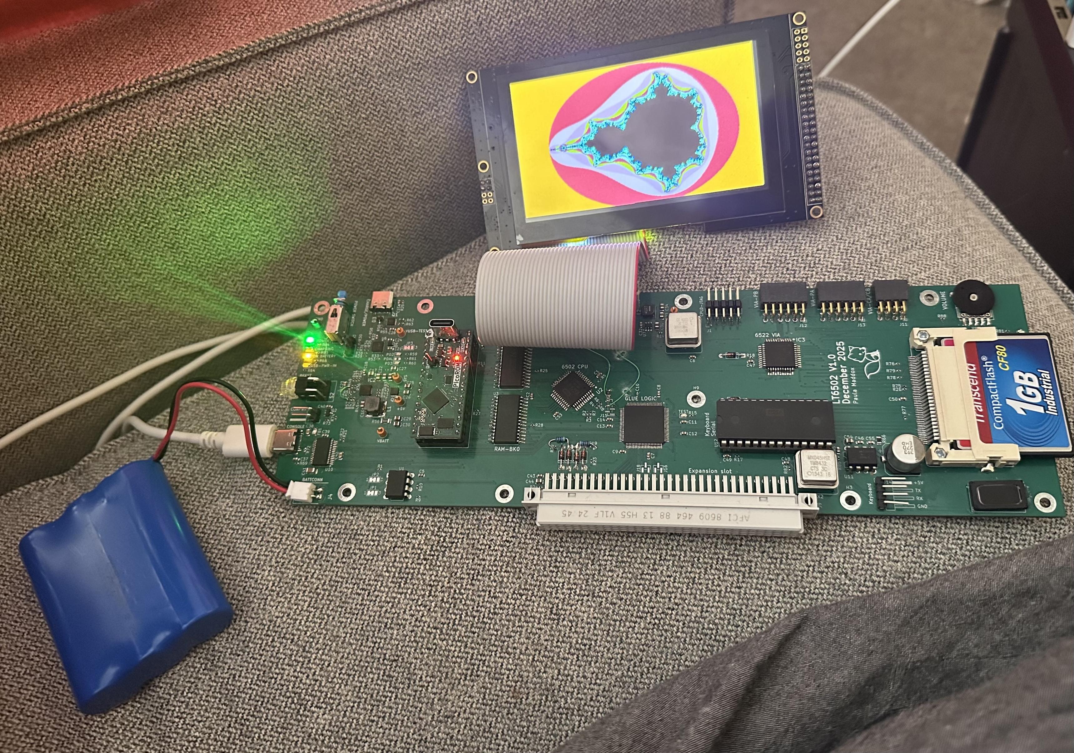

BTW, I made a version of the code to work with the 800x480 RA8875 driver, might help you with the timings for yours
https://github.com/TechPaula/LT6502/blo ... MANDLE.BAS
Works a treat :)

That’s a nice-looking board.  What method did you use to solder the fine-pitch SMT parts?

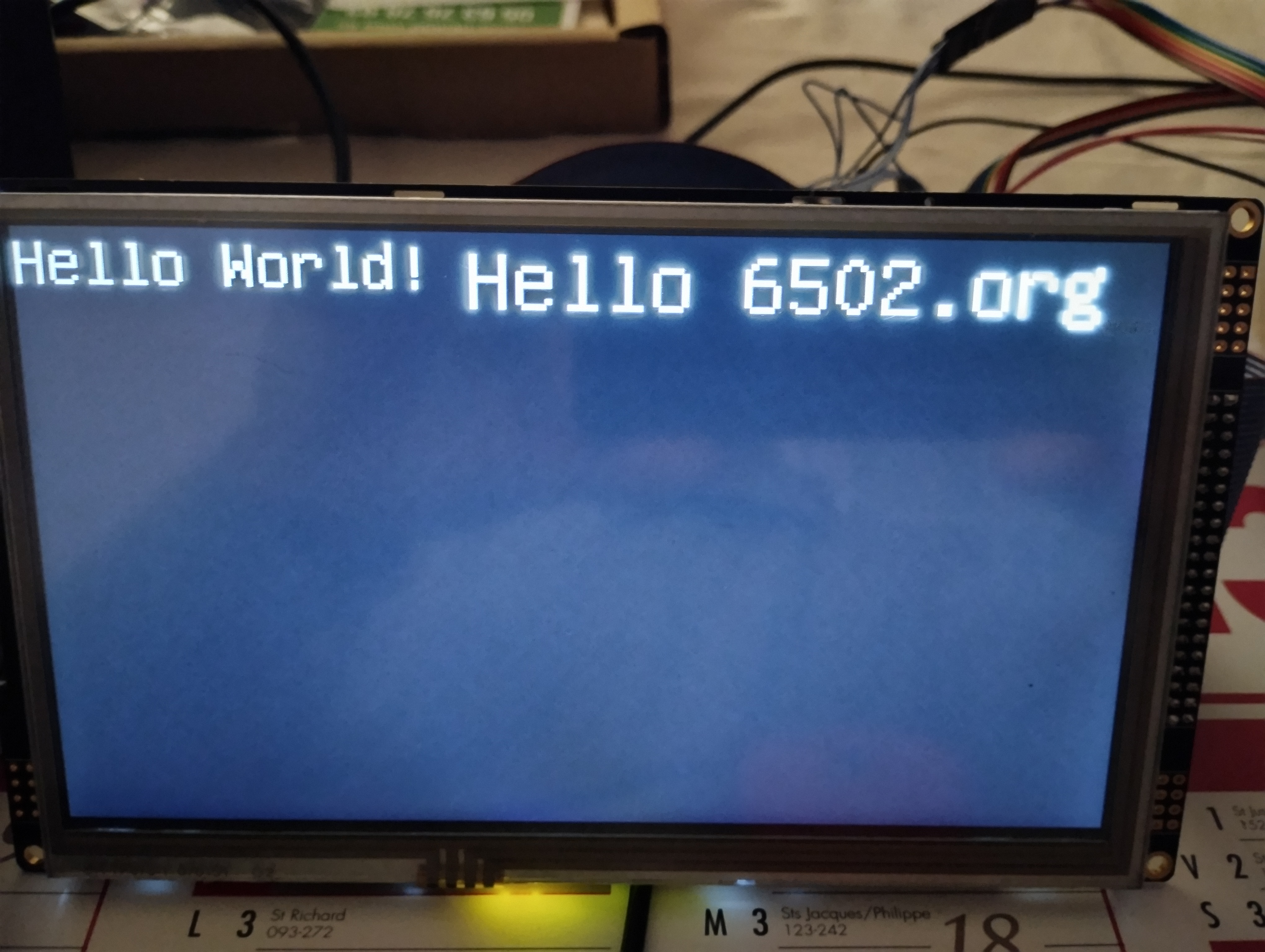

Sorry for the radio silence - my wife and I were both infected by a nasty virus - by the family! Over a week spent with fever and not eating... Not ideal conditions for thinking or working, so it was self-inflicted lockdown.
The brain cell has started to function again, so armed with Paula's suggestions I worked through my code again and corrected many values. It all helps understanding!
Hello world
Hello world
Needless to say, with the right parameters - it works. Thanks Paula, thanks all. The display works a treat in // mode, driven by a 6522. This now opens the way to a small, portable, device.

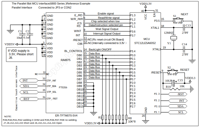

Yes, it's a 7" display. I had to rewire all of the jumpers to get it to work in 6800 // mode, it was hard-wired for 8080 mode. I followed the diagram to the letter, and presto! the beast came alive.
Note the jumper list...
