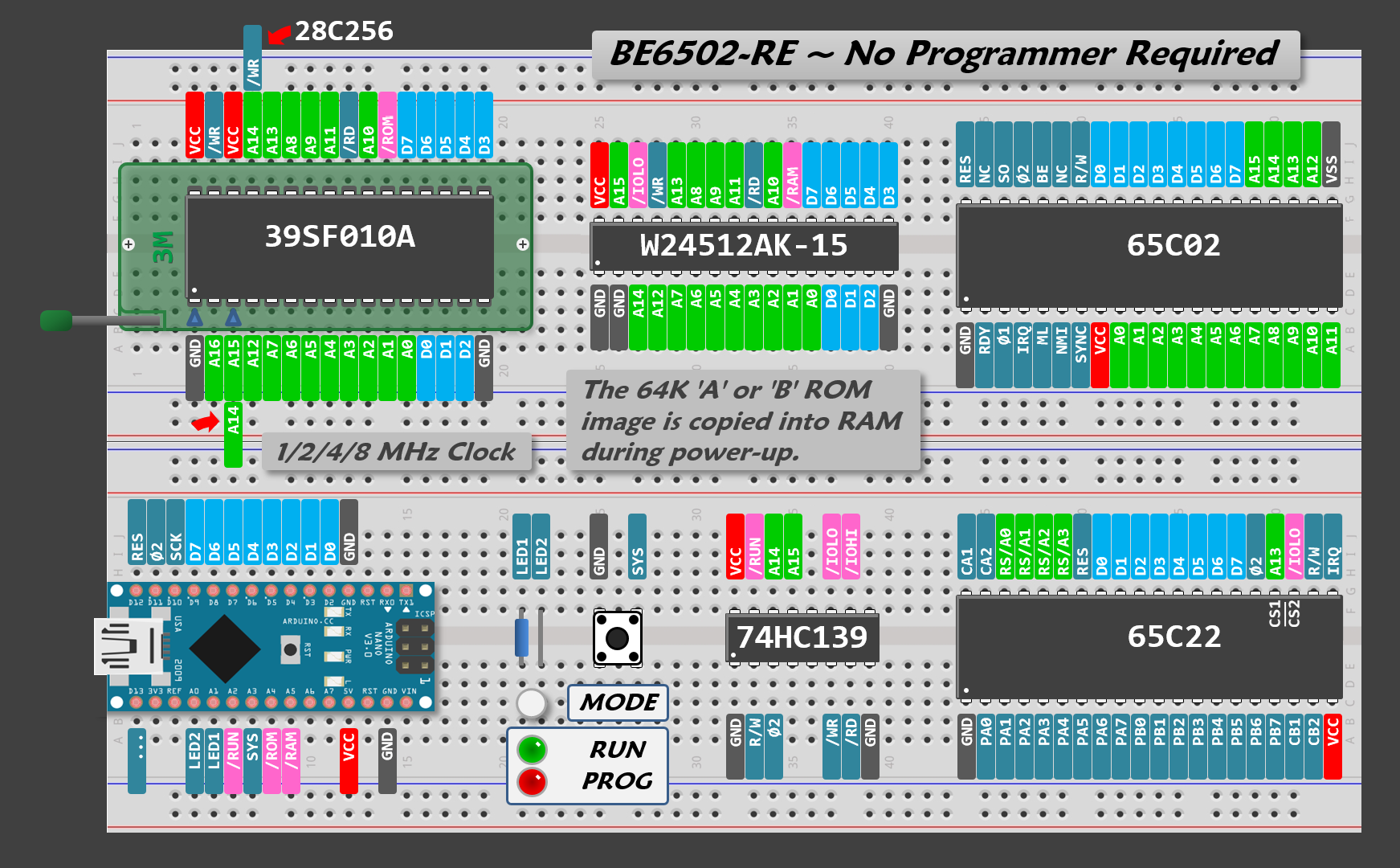

I'd like to experiment with a 6502 system, initially building it on breadboards, before getting a PCB made.
I'm aiming for something like an Apple IIc+, but with better VGA graphics and sound. I'll use an Arduino Nano R4 for that, as I know the Arduino world well, and nothing about FPGAs.
I've come up with the following shopping list of parts. I'd like build iteratively and then experiment with address decoding logic and RAM banking.
I've put a bunch of oscillators in there, but I'll use a Arduino Nano (8 bit) to step the clock to start with.
Is this a good list to start with? Is there anything missing that you would add?
