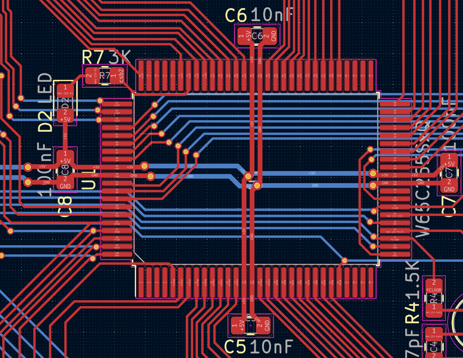

I removed the 0.1uF caps and tested the board without C5 and C6. It was extremely difficult to get a clean reset. So decoupling caps are definitely needed.
I cleaned the PCB and reinstalled 10 nF caps for C5 and C6. The reliability was the best of the three capacitance values (0.1 uF, 10 nF, and none). I will stick with 10 nF for C5 and C6 matching the WDC w65c265qbx values. The upside of this test is I'm getting really good at SMD rework.
Hypothesis: The power and ground lines for the w65c265 all come from a single pair from the left side of the board which run under the chip and provide power to the four pairs of power pins (see attached image). I'm wondering if during reset power demands are high enough to intermittently cause ground bounce.
Test: Run independent ground wires to the C5, C6, and C7 decoupling caps.
If this fixes the problem, I will accept BDD's chastisement for not doing a four-layer board.
If it doesn't fix the problem I will build the second board to see if the problem is reproducible.

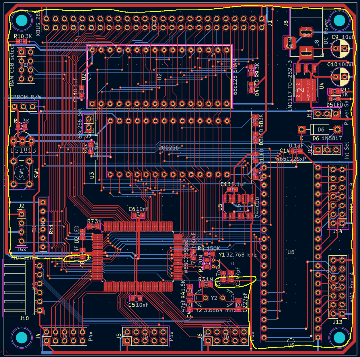

Re: An Improved MENSCH™ Microcomputer
I ran independent ground wires to the C5, C6, and C7 decoupling caps, re-tested, and got interesting behavior.
Good news: When it worked, I was able to run off power from the USB port. That didn't work previously, so it's a minor improvement.
Bad news: The reset behavior was significantly worse, and in a big way. This isn't a fix and made it worse.
Conclusion: Working USB power makes me wonder if it still might be a ground bounce issue.
Epilogue: Since it wasn't a fix, I removed the ground wires and unfortunately damaged the C5 ground pad. I had to resolder the decoupling cap directly to the trace by turning it slightly cattywampus. It works but isn't pretty, so much from my improved SMD rework skills.

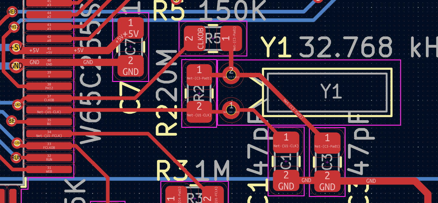

I'm looking at the ground used for C1 and C3, the caps on your 32kHz crystal. In order to connect to the ground that the processor is using, is it true that the trace goes down towards the south edge of the board and then all the way east to that corner, then all the way north to that corner (where it meets up with the power supply connector), then all the way west to that corner, and then finally halfway south before it comes over to the processor?
The ground used for the crystal caps should be a very short connection to the ground used by the IC driving the crystal. You may just want to add a little jumper from the ground on C1 over to the ground on C7 to make a direct connection there. If that helps, then you may want to cut the trace leaving C3, as that ground is carrying current from other ICs like U5, the 7400. Your other crystal might benefit from the same treatment.
Thanks for the feedback and ideas.
Software success first. I have setup a tool chain using make, ca65, ld65, and srec_cat to produce s record files. I then use TeraTerm's send file function to load the s records into RAM, hit reset, and use the monitor's J command to execute. Having to hit reset to terminate the s record load is likely because I'm missing a termination record. But I don't understand s record well enough yet.
Your description of how the ground reaches the loading caps and processor is correct. How that could cause oscillator instability also makes sense. I will try a wire from C1 to C7 to see what happens.
BTW This is interesting because in a previous test I ran additional ground wires for the processor decoupling caps which made the problem worse. That hints at some sort of grounding issue, but perhaps I tried the wrong solution.
I'm using the default boot load/monitor.
Once the slow clock is running it is independent of reset.
If all IC's are on the board and power is supplied from the DC jack. It works most of the time. When it doesn't the slow clock either doesn't start or looks unstable.
If all IC's are on the board and power is supplied by USB. It doesn't work at all, and the slow clock either doesn't start or is unstable.
If the only IC on the board is the W65C265 and power is supplied by USB. It works intermittently. But when it doesn't the slow clock either doesn't start or is unstable.
Interesting data point. When using USB power, the ground comes from the FTDI jack and travels around the board counterclockwise. That creates a situation where the distance from the loading cap ground to processor ground is greatest.
Fantastic news. SamCoVT your diagnosis was correct.
I ran a small jumper from C1 ground to C7 ground. I went for gold and connected USB power with all chips in their sockets. The Mench monitor displayed the boot prompt. I hit reset 30 times and there were no reset problems. That never worked at all in previous tests and now I have seen no failures.
I am also able to run the board off battery power with all chips installed and it works that way as well.
I will correct the PCB layout to match and upload to GitHub shortly. I'm on the fence about making the minimal change or altering the trace for the FCLK caps as well.
Update: I made the minimal changed to the PCB layout, regenerated the Gerbers, checked in, and pushed to GitHub. Anyone who wants to build one of these should be able to use this design without the headache I went through.
@All, thanks for your help with this project. I now consider it a complete success and will move onto the software phase.

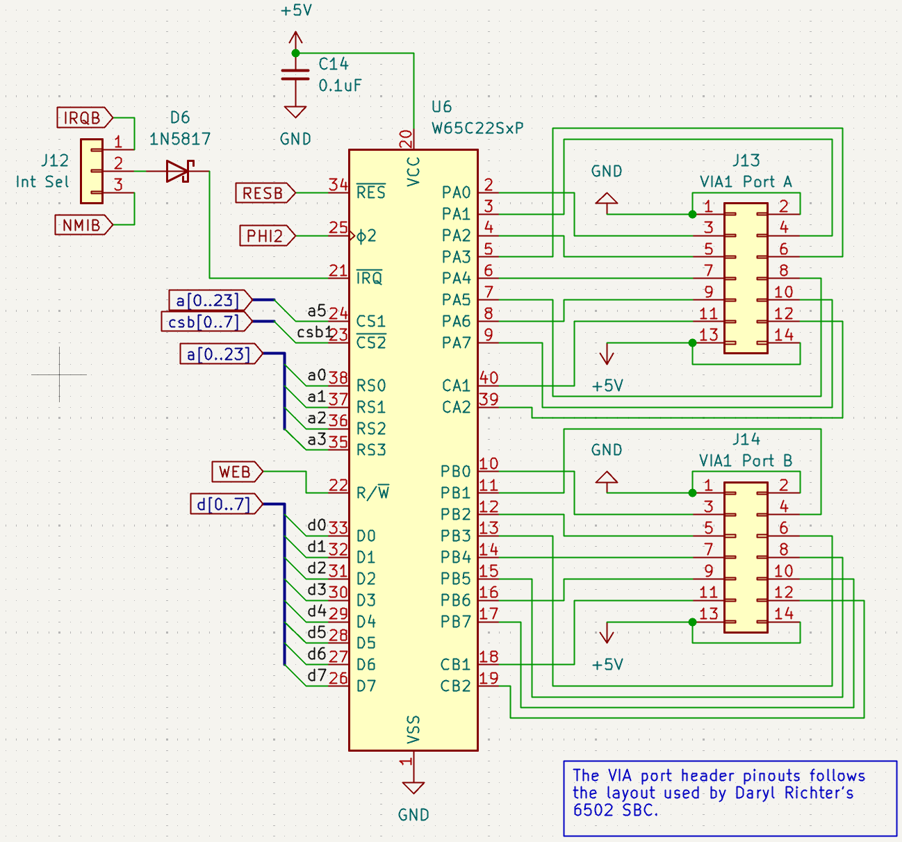

I have written several sample programs and uploaded them to RAM. I can also write to the EEPROM. But I'm having a problem with the 65c22 that straddles the line between software and hardware, and I'm not sure which it is.
The symptom: When I read or write to the address that the 65c22 should be memory mapped to. I get junk. When I write $00 or $ff to it, I don't get those values back. Basically, there doesn't appear to be anything at that address space.
My first thought was that I messed up the bus connections. So, I looked at the 65c22's pinout and validated the data and address lines. I then verified the phi2 was correct and that WEB was connected to the RWB pin. I also compared it to other 6502 SBC schematics that I know work and the WDC Mench computer schematic. It all looks reasonable.
That seems to leave address decoding logic. My design follows the WDC design for their Mench computer which uses this address decoding:
If I understand both datasheets correctly, this should memory map the 65c22 in the CSB1 address space ($dfc0) offset by A5 when its high ($10). Which should be VIA base of $dfd0 ($dfc0 + $10). Does this make sense?
Indeed, when I write or read to $dfd0 my logic analyzer sees CSB1 pulse low. A5 is pulsing all the time so it's hard to know if it's high when CSB1 is low, but it should be high for address $dfd0.
I could be missing something basic about 65c22 interfacing, so any thoughts would be helpful.
