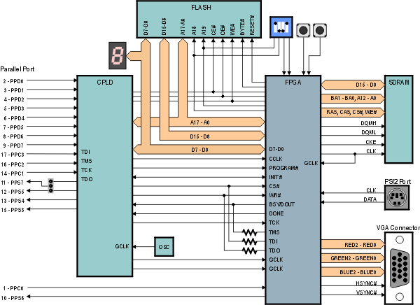

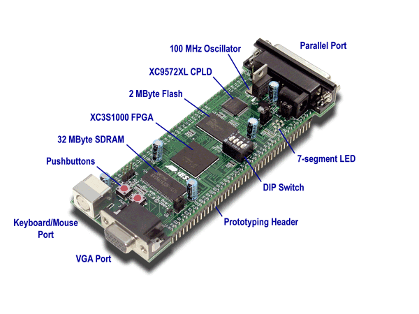

I keep losing the link to this post... so to summarise: it's the XSA-3S1000 for $200, with a nominally million-gate Spartan-3 XC3S1000 FPGA on it, with mouse, vga and parallel port, the GPIOs you mention (not 5V tolerant), 32Mbyte SDRAM (16 bits wide), runs off 5VDC.
In fact the pictures tell that story (but aren't so searchable!):

The XSA-3S1000 is only offered in BGA style packages according to the Spartan 3 datasheet, yet the pic on the site makes it look like a QFP style package. What's up with that?
