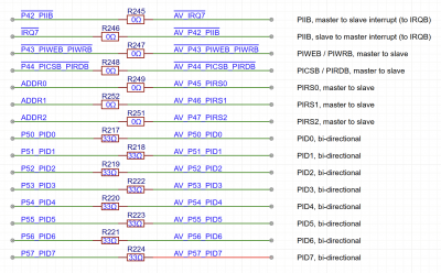

Would anyone happen to have resources to help me better understand hardware and software implementation of PIB (parallel interface bus) on a pair of W65C265S MCUs? I'm very interested in a sample schematic of a PIB implementation, and any code samples would also be quite helpful. I have been scouring through the '265 datasheet, monitor ROM manual and source code, and SXB documentation. I'm working on a dual-265 SBC, and I have too many gaps in my understanding of PIB.

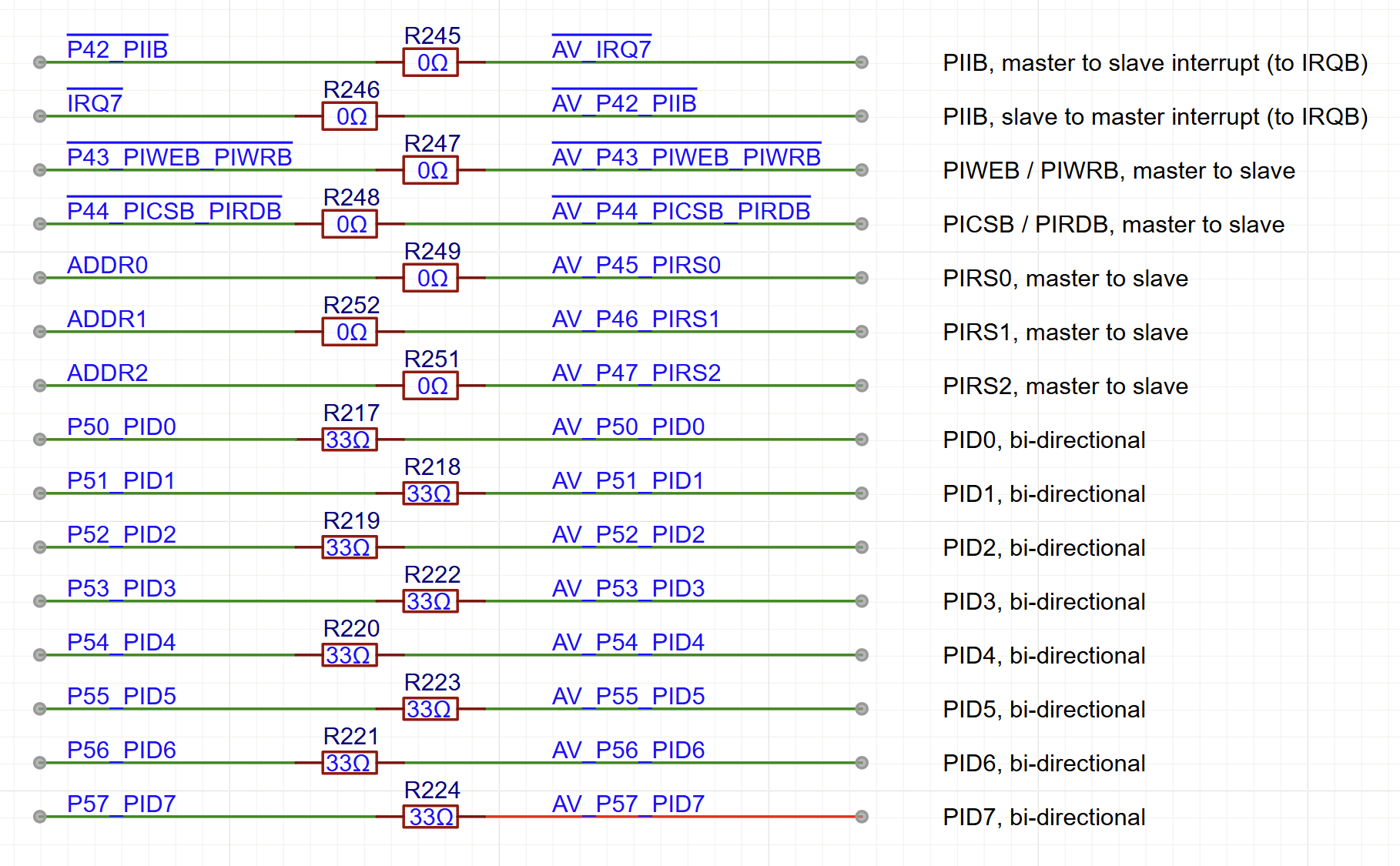

Here's where I'm currently at with connectivity between two '265s. Thanks to handyandy for suggestions on this design. I'll be ordering a first attempt of a PCB for this later this month. I'll post an update when I can validate the design. Thanks!

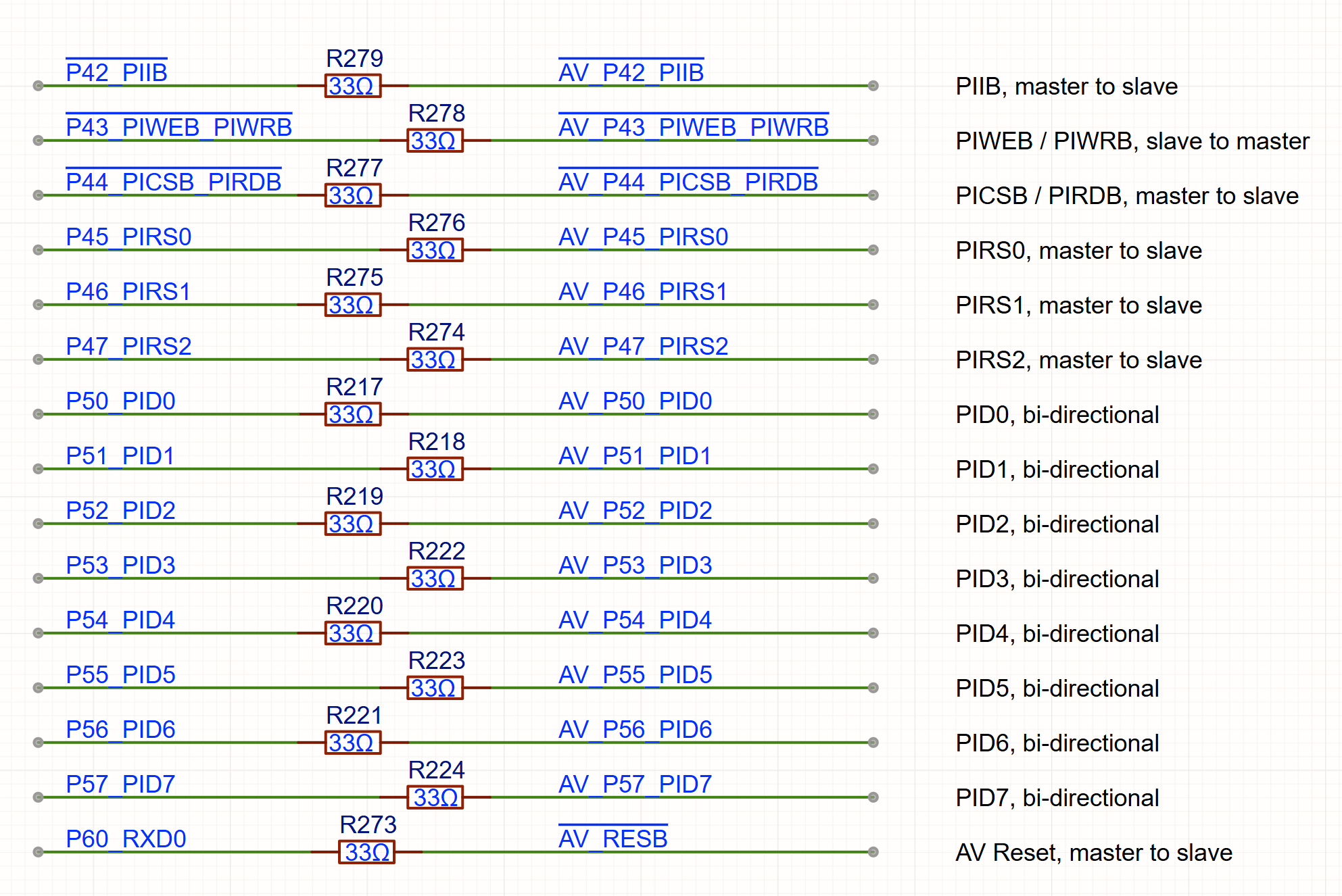

I have PIB working! Below is what I ended up with for connections to connect two '265 boards. For the most part, connect port 4 to port 4 and port 5 to port 5 (minus the NMI and IRQ lines of port 4).
In case anyone is interested, I posted additional details, including code to https://www.rehsdonline.com/post/w65c26 ... ce-bus-pib.
