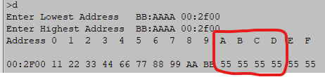

To help with debugging, I do toggle an LED (PD72) in the ISR. Additionally, I am writing to $2F00 some markers to help me track progress as it runs. I initialize this space with 55s and then progressively fill in values just to track progress. The markers I try to write during/in the ISR never happen (should show up as CC DD in $2F0A and $2F0B).

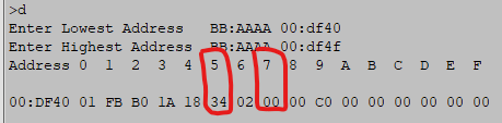

I can read the EIFR ($DF45) after pressing the button that should trigger the interrupt, and I see a value of $34, which includes the %00010000 bit for NE64, indicating the MCU recognizes the interrupt (along with two other interrupts, probably from monitor ROM activity).
I have also checked EIER ($DF47) after jumping to my code, before pressing the button. I can verify the bit for NE64 is enabled (and the only bit enabled). After I press the button to trigger the interrupt, NE64 is cleared out of EIER (assuming the monitor code is doing this, as my code only enables the bit during initialization and does not modify it after that).
I'm leaning towards something is wrong with my ISR vector setup -- how I'm defining them, how they co-exist with the monitor ROM (and if the monitor is conflicting), simultaneous interrupt handling, etc. I question which addresses should be used for the shadow vector setup and whether BCR needs to be modified. This could also be an issue with my assembly coding (stack management, register width, or some other silly mistake).
