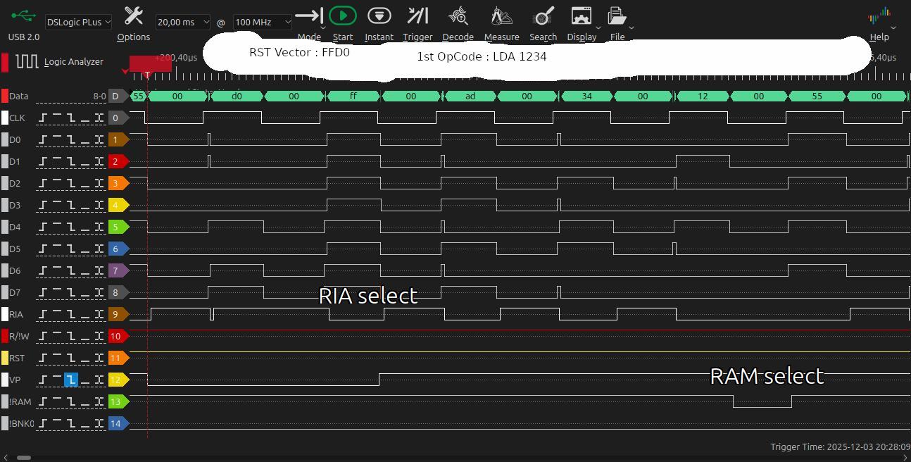

Hello all,
This will, I hope, turn into a "Doh !" moment - but I'm currently stuck with what should have been simple logic inside an ATF1504.
I need to set the scene : I'm working on my 65816/Pico2 prototype - a spin-off from the original RP6502_Picocomputer. The Pico2 has been reworked to not stumble over the bank address moments when the clock is low, and has the full 32-byte vectors area for the 65816. Address decoding is done in the ATF1504, it is also capturing the bank address and setting external pins that correspond to each 64k bank (from 0 to 7). So far, so good.
I'm using the 'trick' that I discussed with BDD in a post about the ATF750C chip : pass PHI2 through an internal F/F and use it to latch the bank address : using the (short) propagation delay to get the BA a short while after PHI2 falls. Here's what I did to make it work : (CUPL language)
PINNODE 45 = BA;
... some other logic...
BA.ck = CLK;
BA.d = !CLK;
/* Bank address decode */
Banks.le = BA.io;  /* .io is the O/P of the F/F : should add a small prop delay */
BNK0.l = Data:'b' 000;
... and so-on for banks 2..7
This works quite well, I'm latching the bank address very early during PHI2 low. Here's a picture of it working : (RIA is the Pico2)
The Pico2 is emulating the boot rom, selected in the region $FFC0..$FFFF (in bank zero). You can see the vector addr. and the first opcode.
Now to my question : You can see that RIA is being de-selected when PHI2 is high :how do I maintain my latch contents during PHI2 high, and only relatch the bank address at the next falling adge of PHI2 ?
Thanks, in advance !
(edit : modified the question for more clarity (hopefully))

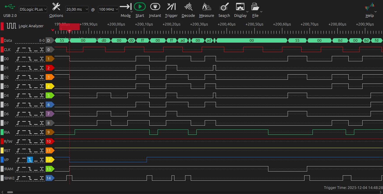

Well AFAIK the latch operators should enable a standard latch circuit, like a 74xx573 :
TI wrote:
When the latch enable (LE) signal is high, the Q outputs follow the data inputs. When LE is low, the Q outputs are latched at the logic levels of the inputs.
So, I went back to basics instead of trying to be clever, and reverted to the 'standard' approach which is to just latch on !CLK. This gives :
Latching with !CLK
Latching with !CLK

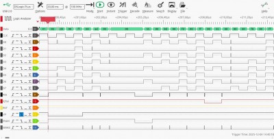

Which shows that the bank output is latched during CLK high, but those little glitches become more and more of a problem as the PHI2 frequency increases. At 7MHz the picture is (sorry BDD, colored screen capture) :
... and at 7MHz
... and at 7MHz
Which is becoming rather messy. Which is why I was looking to slightly delay the latch signal. I'll keep playing !
(Although I've started to have problems with 'unlocking' my ATF1504s that I programmed, 'cos I disable the JTAG pins to use them as I/O. (Used 43 of the 44 available pins :cry: )
