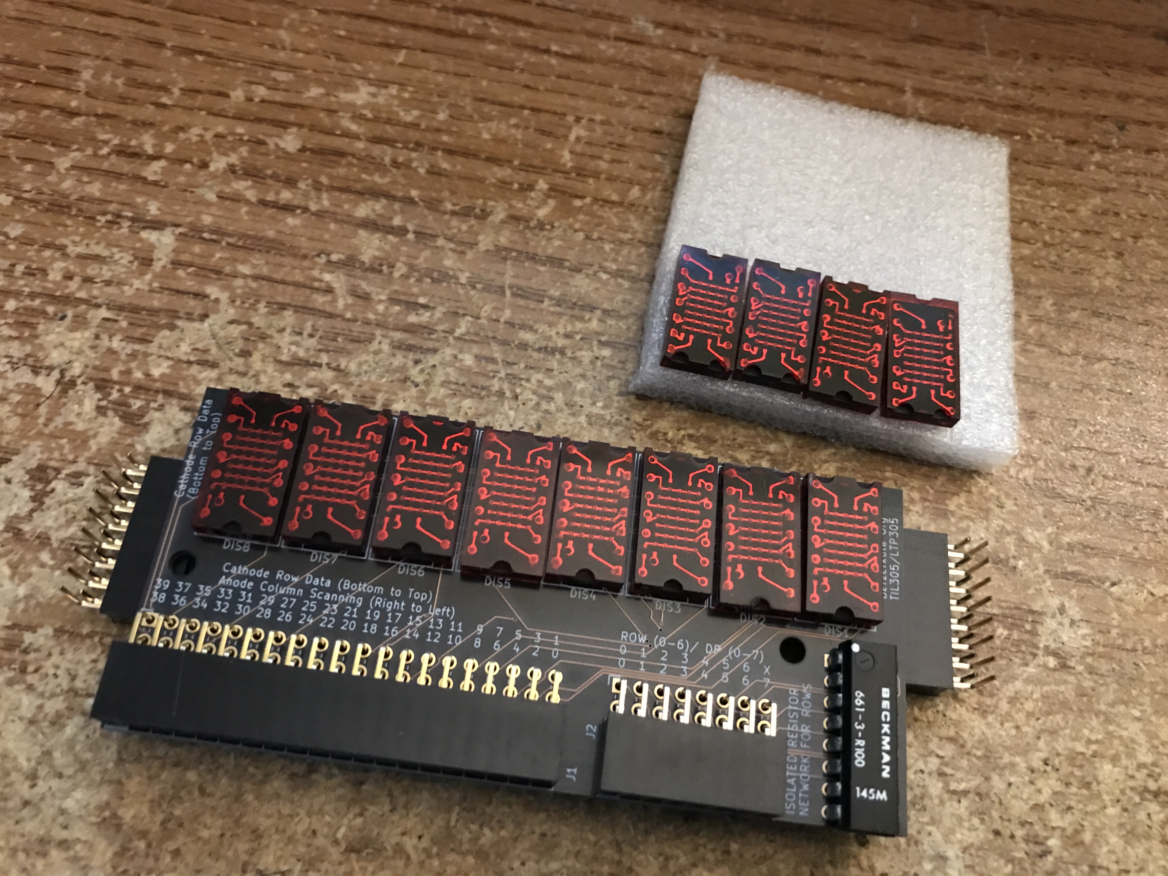

I first got started with CPLD's with the CPLD trainer from plasmo. I only dabbled a bit from examples in books and others. This time I took on another challenge. I have a bunch of TIL305/LTP305/LRT1704 5x7 dot matrix displays. Also, some newer ones from Pimoroni. My goal? Output the hex value at a specific 32 bit address for some machine. In this case, an M68K type machine.

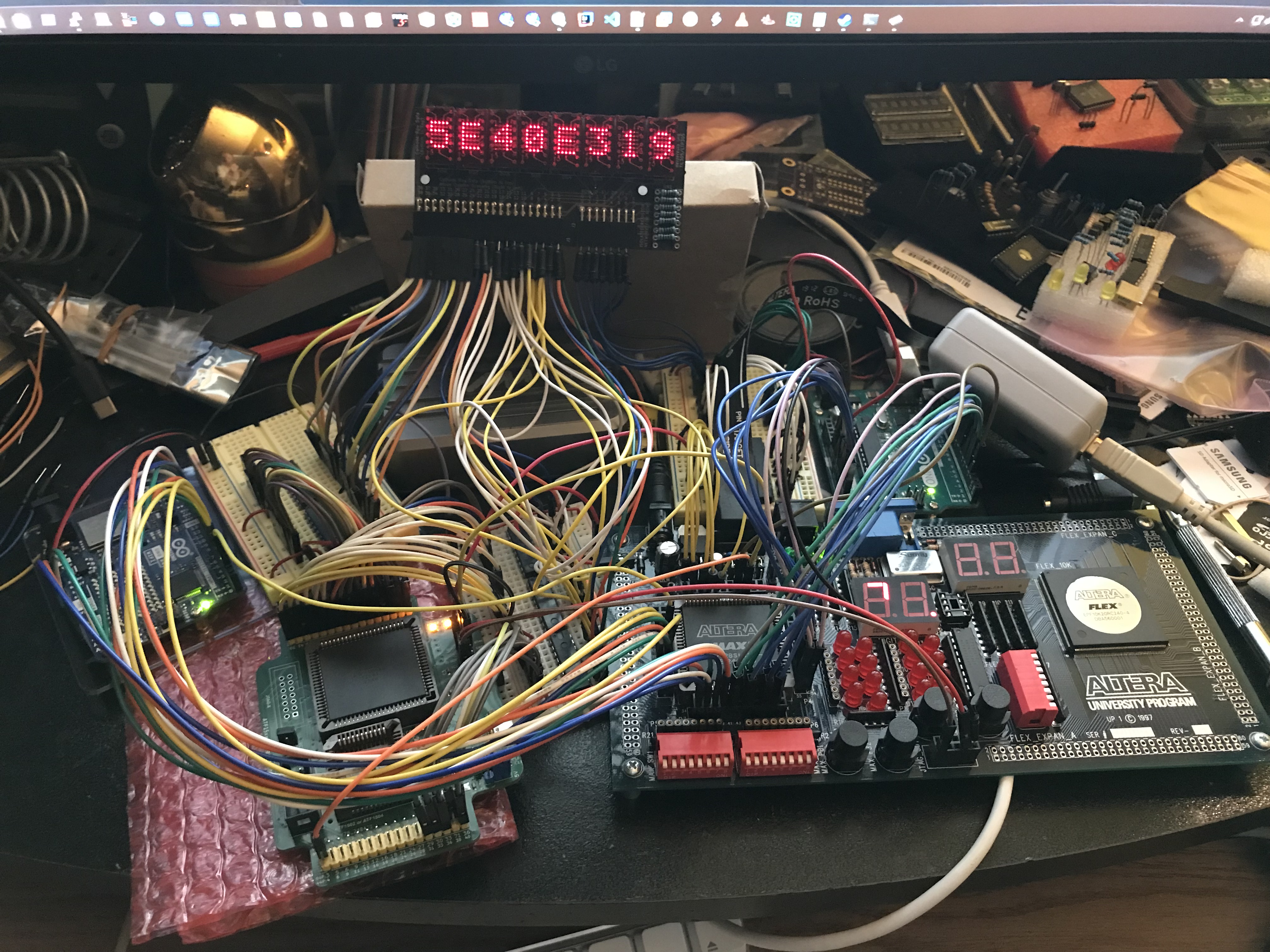

This project was started in August, and just now, got to the point where I can drive 8 of these displays. There are probably many ways to bite this beast, but I've used Maxim 6952/3's and some other devices that do all the hard work when multiplexing or charlieplexing. I decided to figure how to drive these bad boys with 2 CPLD's and supporting drive hardware.
All of this has been prototyped using Altera evaluation boards, ATF15xx boards, bread boards, darlington arrays (UDN2982A for the columns, ULN2803APG for the rows) AT28C16 (character ROM), etc. I've been simulating 32 bit data input from an external source.
It took quite a bit of work getting to this point, but starting with figuring out how to multiplex a 5x7 display, column scanning (programming a custom ring counter) and sending row data and keep it synced took quite a bit of effort. However, it is possible using 2 EPM7128/ATF1508AS CPLD's with supporting driving hardware.
I present the 8 digit 5x7 custom driver! Still a huge work in progress! (Only recently fabricated a PCB for the 5x7 displays with anode column/decimal point with cathode row limiting resistors.

The column scanning isn't demanding, but the row data driver is demanding and I have been able to get Quartus 13.0.1 Build 232 06/12/2013 SJ eb Edition with SP1 to build and get 107/128 (84%) macrocells after some tweaking.
For the column scanning (Using the ATF1508AS for this, use POF2JED and program with an ATF15xx programmer)

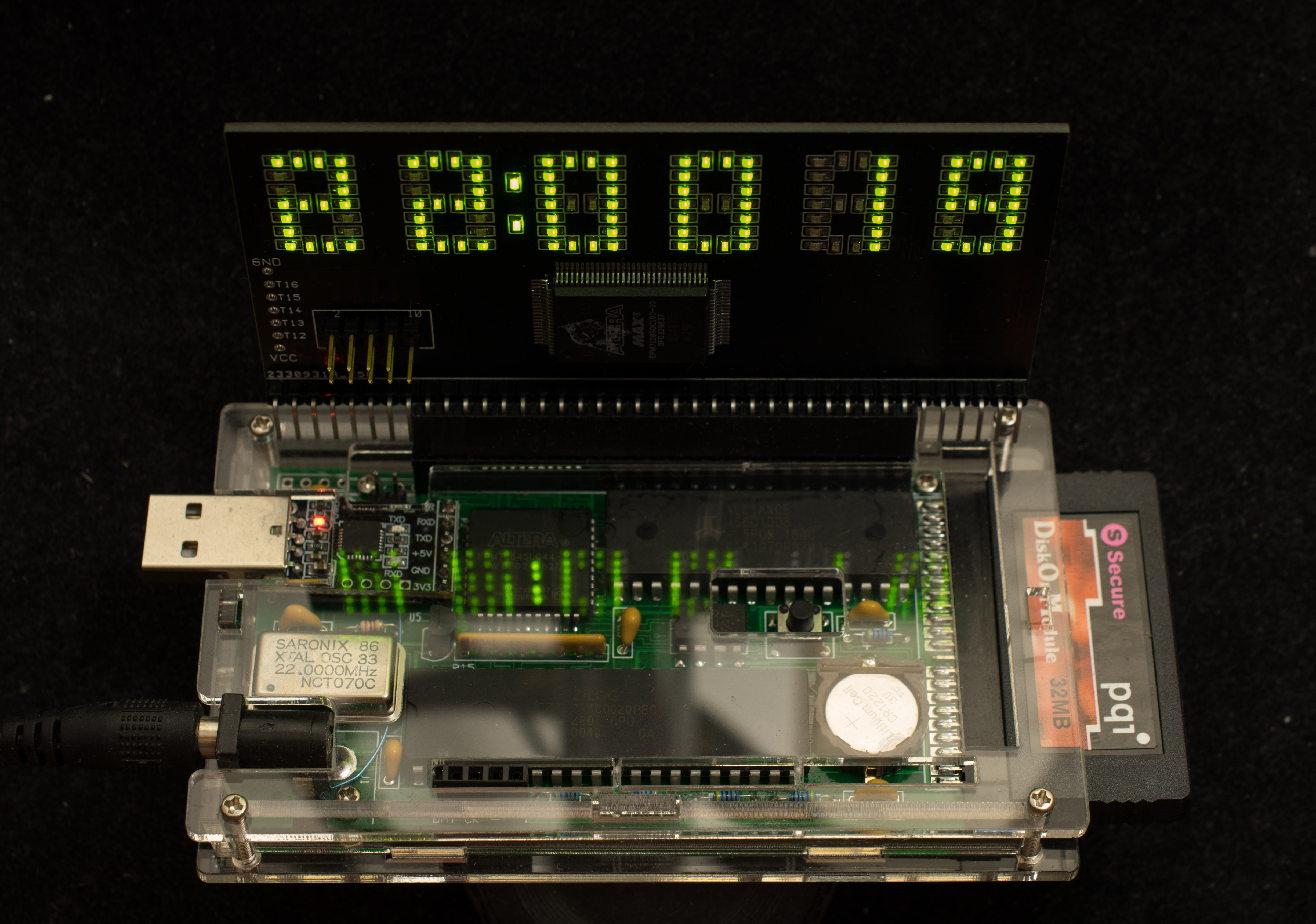

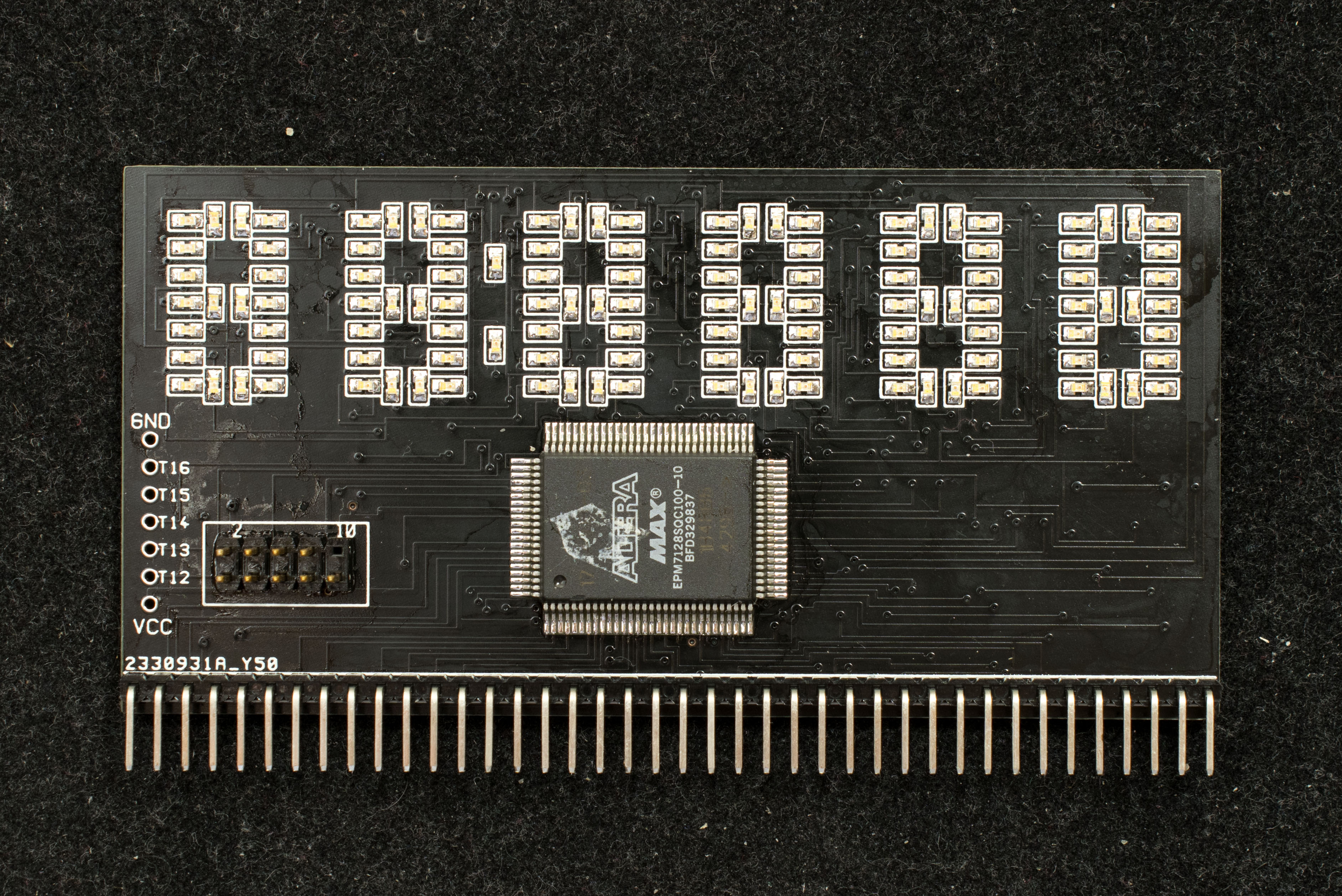

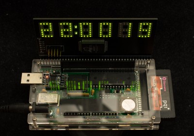

Your multiplexed dot-matrix display reminds me of similar display I built up from individual 0603 LEDs and the associated CPLD to drive it. There are 6 digits in this homemade display, meant to display addresses and data on RC2014 bus. Each digit has 20 LEDs, so there are 20 row drivers. Since only one LED is driven at any given moment, row drivers need no buffer, other than current limiting resistors. Each digit does need a FET driver to sink 20 LED's current.
It had been 15+ years since I used Verilog, so I don't remember it anymore, so I designed the CPLD in Quartus schematic. Quartus schematic consisted of latches for each digit, 6-to-1 mux to drive the ROM that translates 4-bit hex input to 20 LED rows, and a ring counter to successively turn on each digit. The design used 65% macrocells of EPM7128S CPLD.
CPLDTIL_CPLD_scm.pdf
(23.92 KiB) Downloaded 36 times
