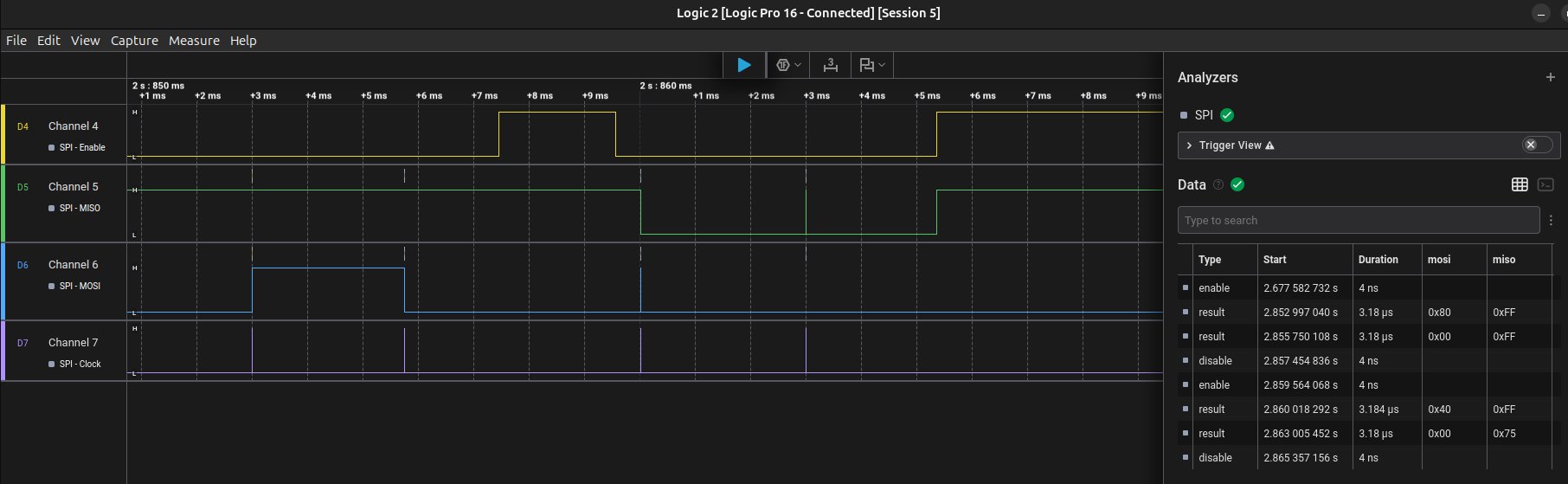

Re: 6502 with the RA8875
I swapped the TXB0108 for a TXS0108 and I'm having more success, thankfully it's a drop in pin compatible part!
I've finally got data back from the RA8875 via the 65SPI2 CPLD.
Here is my code
I have to do a dummy write to read data, which isn't what I was expecting as I thought the FRX bit on the 65SPI2 would drive the SPI clock when a read happened, at least that was my understanding of the data sheet.
I can see that without the dummy write the SPI clock doesn't happen
Anyway, also attached is a screen grab of the data (now clean!) with the TXS0108 in

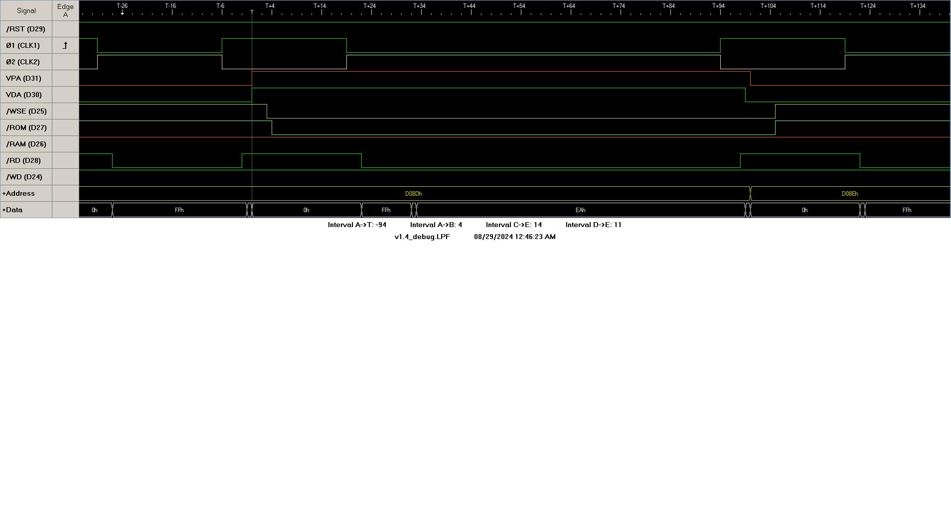

For now I'd like to work on SPI to confirm I have the config correct.
Basically I've got it working on a teensy, captured all the data going in/out (lots of print statements to print to the console) and rebuilt the code from that
Here is what I have in my basic code https://github.com/TechPaula/PC6502/blo ... OWORLD.BAS
and here is the output of the program https://github.com/TechPaula/PC6502/blo ... OUTPUT.TXT
the output of the teensy console is here - https://github.com/TechPaula/PC6502/blo ... OUTPUT.txt
I've added delays to the basic program where needed (1mS, 500mS, etc)
I'm not posting code here as it's 400 lines long and the output is also many many lines long and the output log files are also quite long.
If anyone spots something obvious please do let me know.

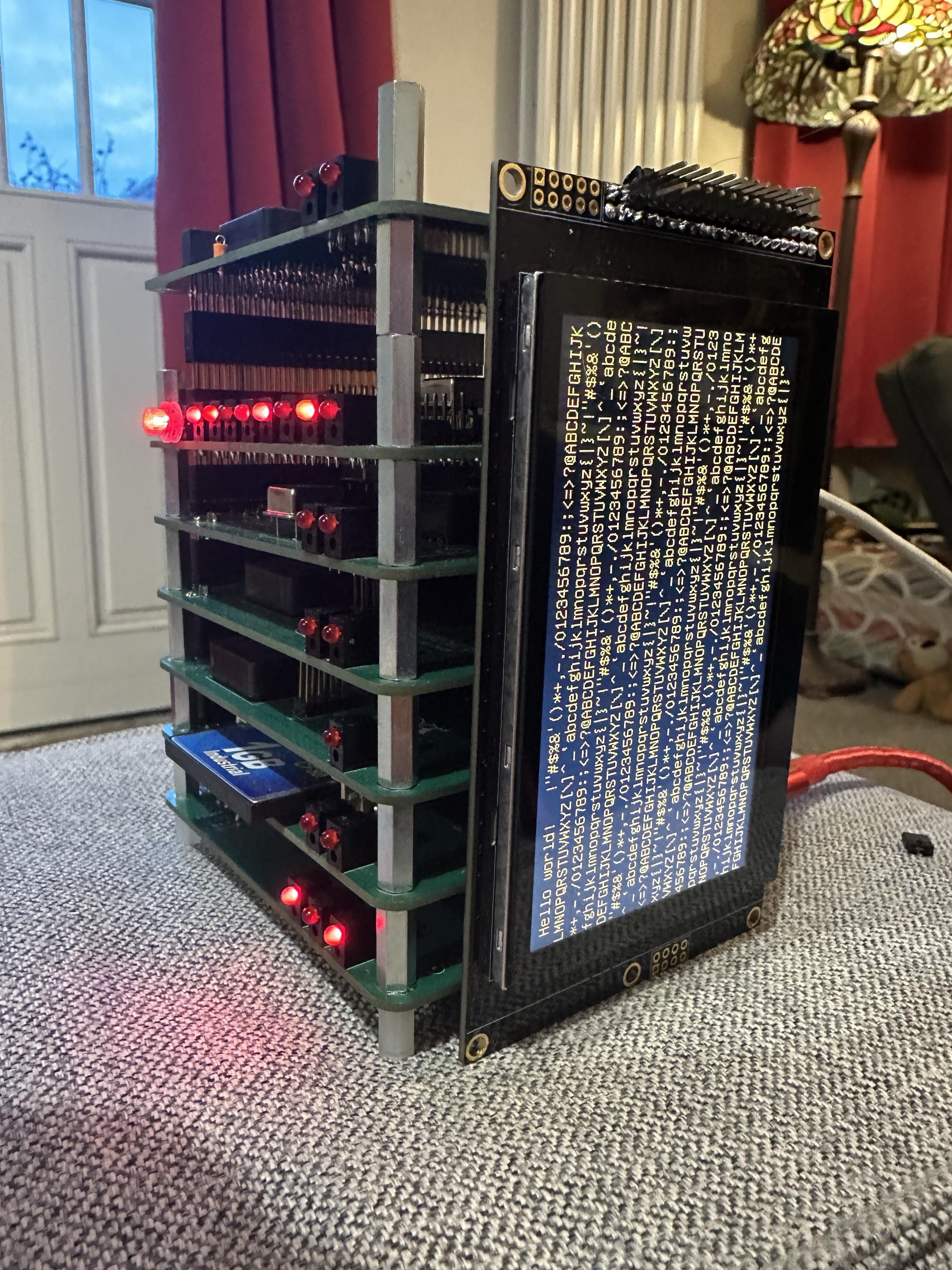

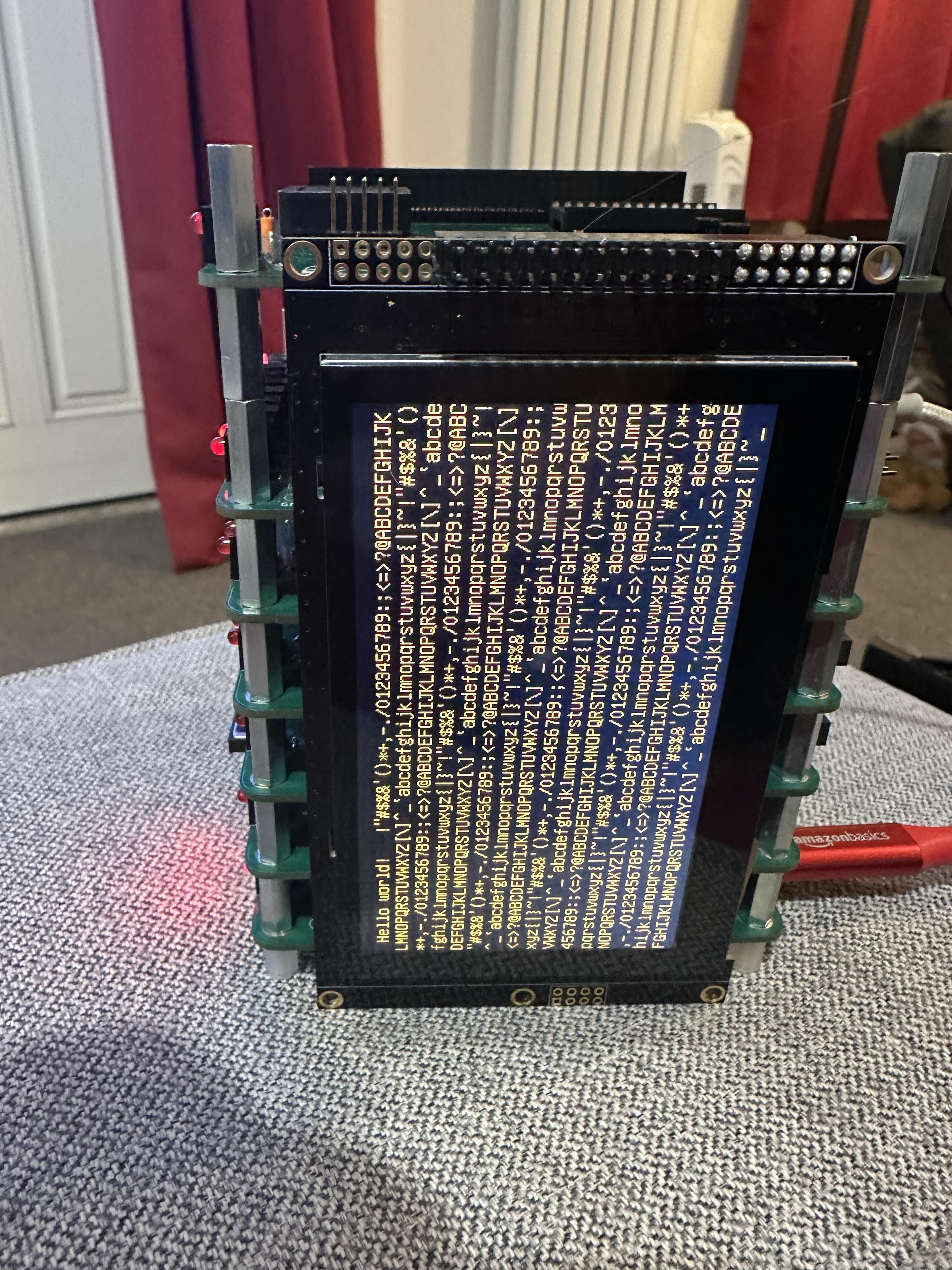

bytearray wrote:
Any progress on the RA8875? I have a running RA8875 display (800x480) on my 65c02 breadboard.
I can't find many people using the RA8875 with the 6502 (probably since it is cheating to have a display controller chip that powerful on the 6502
I am running it in text mode and using it as a text terminal. I am talking with it through SPI. It works great. The initial setup sequence is a bit long (since the RA8875 have so many registers). If you want I can share my codes for the initial setup sequence through SPI?
I am not planning on using any of the touch functionality but just as a text terminal display. I might venture into some graphics mode later for some of my programs.
Or I have considered splitting up the screen so the left side has the text terminal and the right side some static area with information about the time, current directory, and stuff like that.
Attached is a picture of it in action.

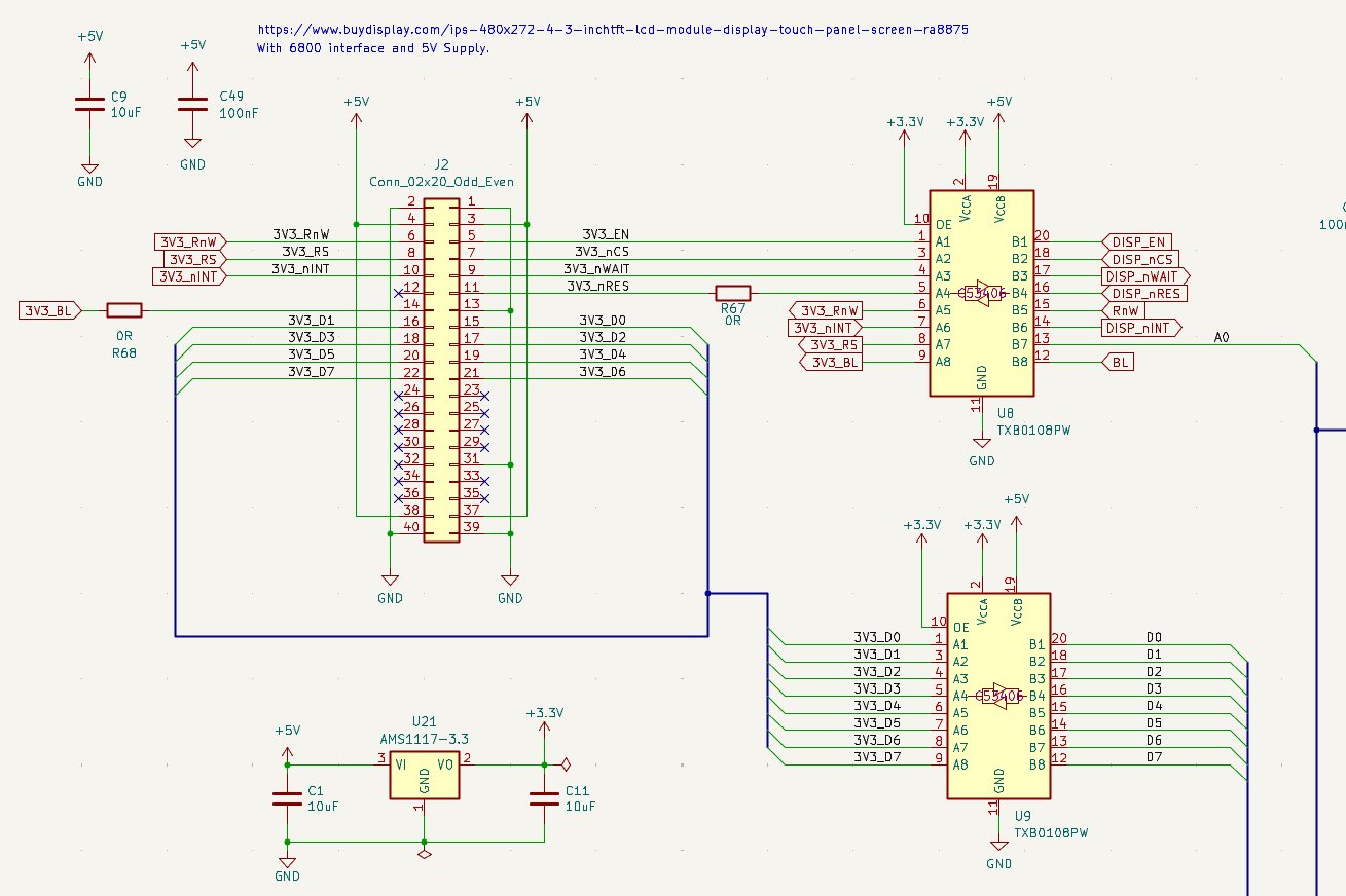

GlennSmith wrote:
Hi Paula, could you post the wiring diagram for the 6800 mode (once you're sure it works)
Thanks. You're faster than me, I'm still in the 'reading the manual' stage, and wondering the best way of interfacing through a 65C22.
