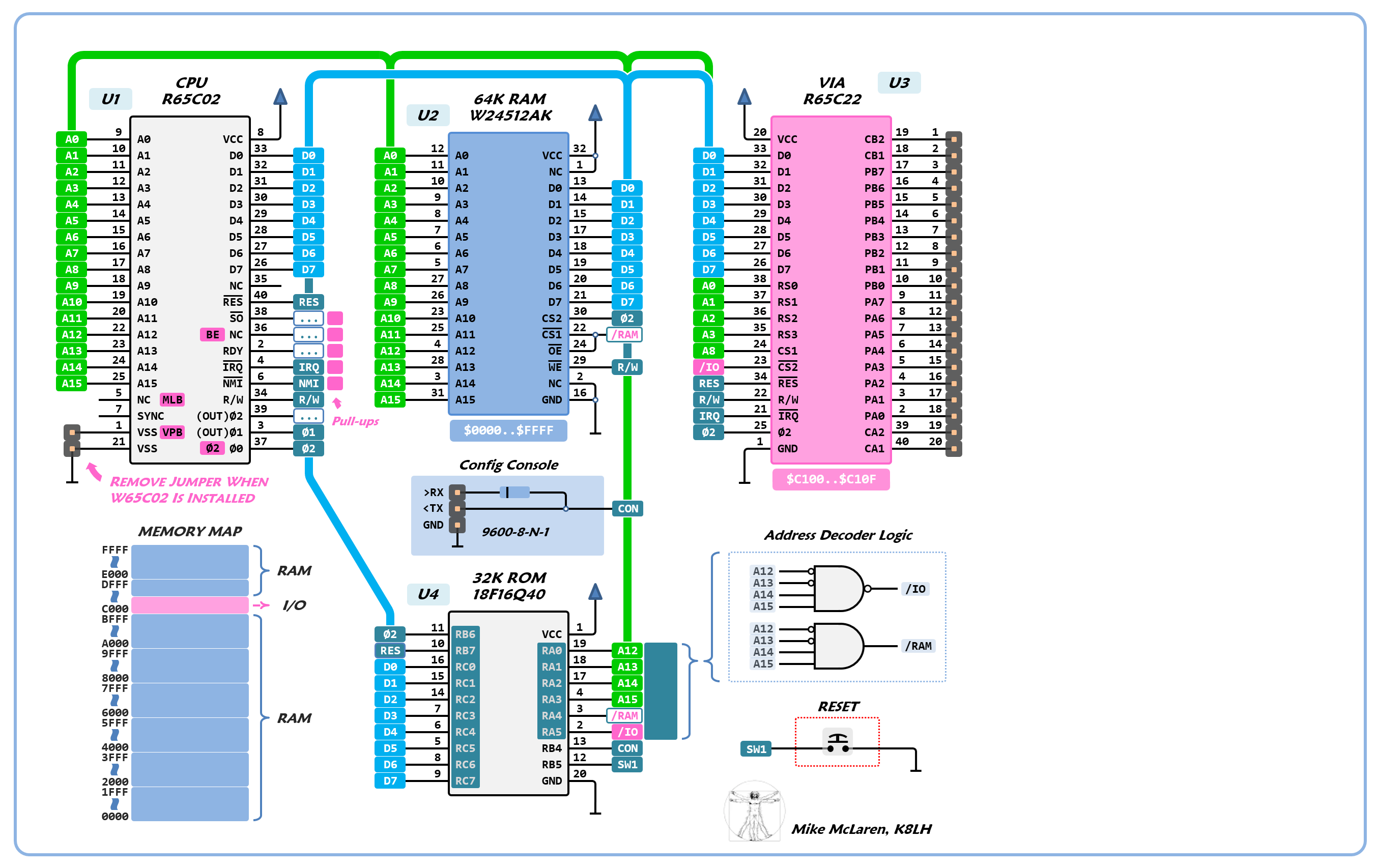

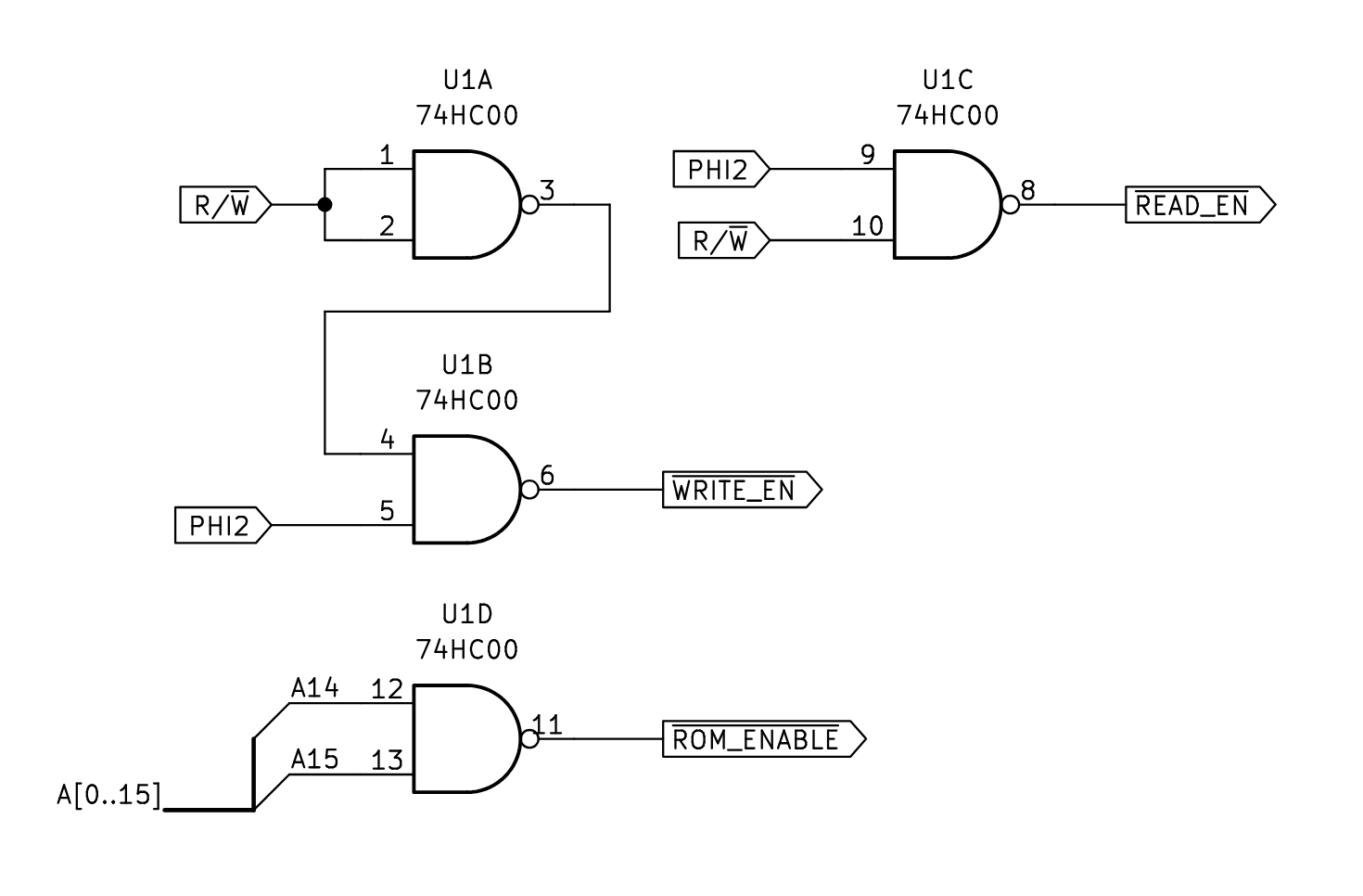

Here's the decode logic I'm working with:
From re-reading the 65C02 datasheet, it seems that pulling BE low puts the address and data buses into high-Z, and does the same for RWB. So I'm assuming that the MCU can take over those signals. If so, all I need to know is if it's safe to hold the PHI2 signal low with the MCU. The signal's coming from a bog-standard oscillator can.

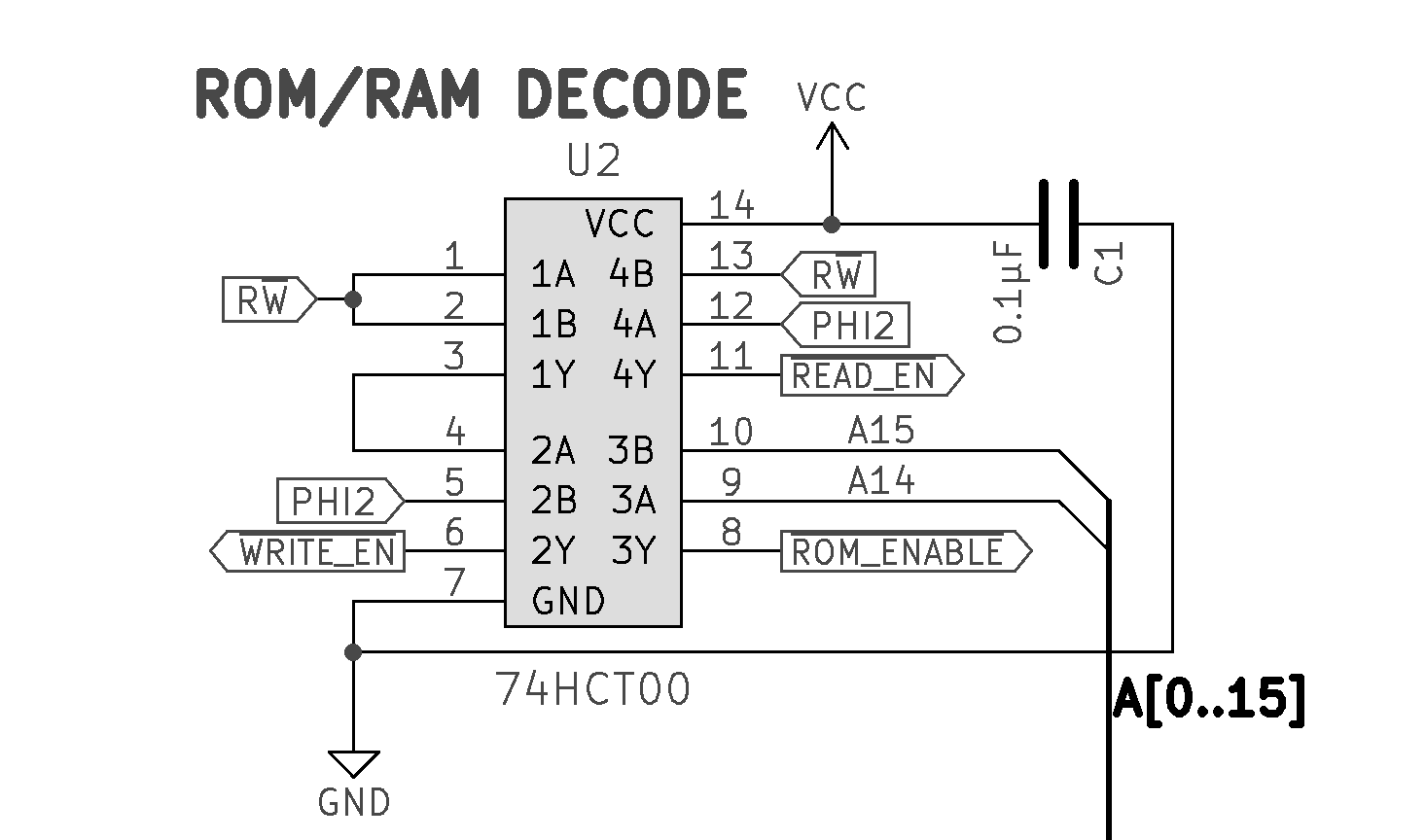

Suggestion: in your schematic(s), components such as the 74HCT00 should be drawn as individual gates for clarity, instead of as a rectangle with connections. For example:
With the gates individually depicted as in above, it is much easier for the casual reader to discern what the circuit is expected to do.
That is correct. You do need to carefully consider your timing to assure that the C02 high-Zs the buses and RWB before the MCU takes control so as to avoid any contention. Also, be sure to consider that BE is an asynchronous signal, which means driving it low immediately high-Zs everything without regard to the MPU’s state during a cycle. Furthermore, while the time required for the MPU to respond to BE going high is a defined specification, the response time to BE going low is not.

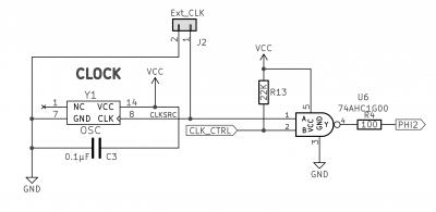

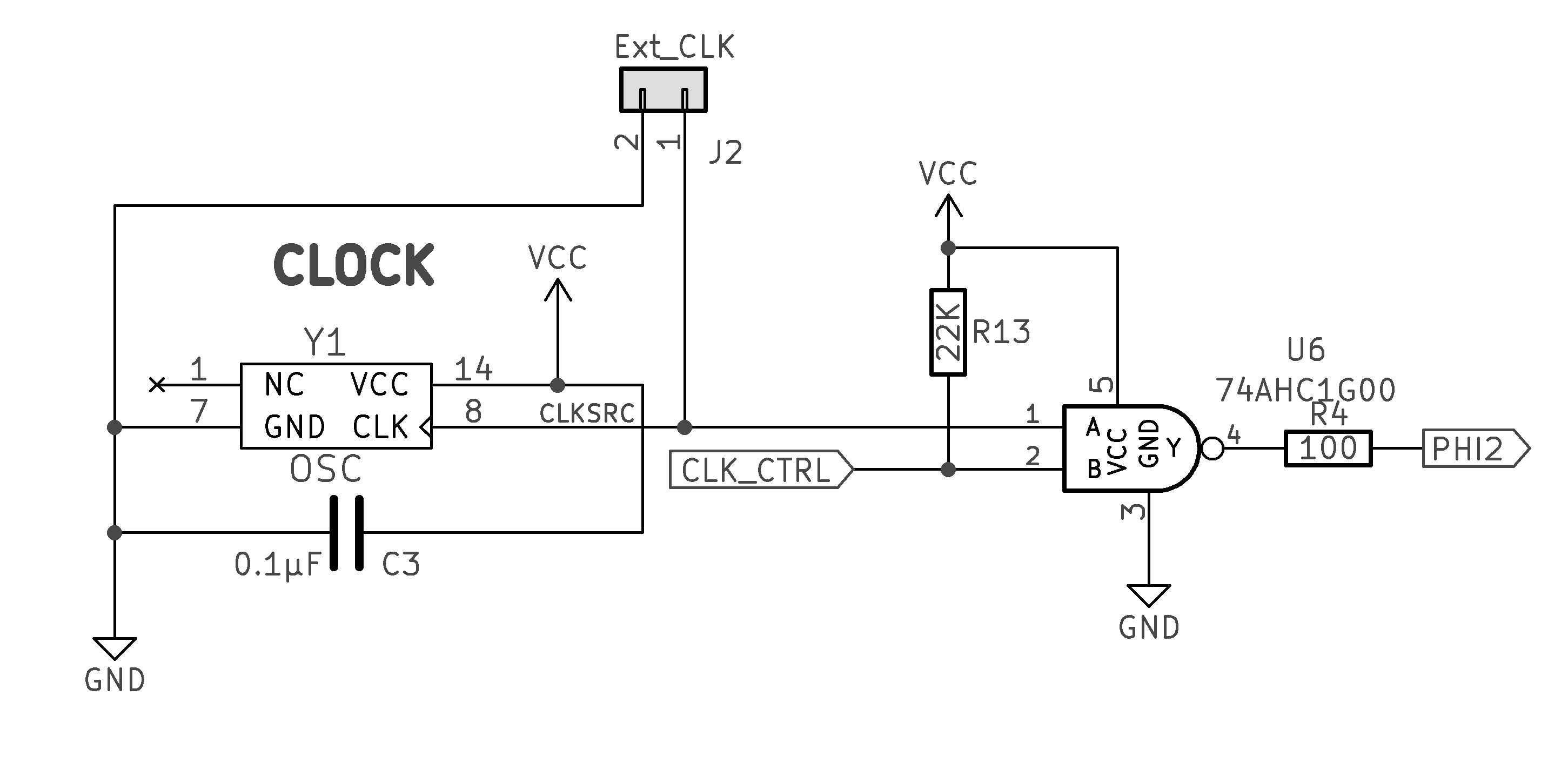

Okay, just in case there's anyone still playing along at home, here's what I've arrived at.
This is the clock circuit:
There's a new NAND gate (an AHC part with an average speed of 7ns). The two inputs are the ouput of the oscillator and a signal from an MCU GPIO I'm calling CLK_CTRL. This line has a pullup.
If I understand this correctly, in its default state, this will just invert the clock signal, which is fine. But if the MCU pulls CLK_CTRL low, the PHI2 signal will remain high.
Now for the next bit. This is the ROM/RAM decode (we're only concerned with the right half of the chip. The left half is for RAM and it doesn't matter what happens to that because we're going to be doing a full reset anyway).
With BE pulled low by the MCU, the address bus, data bus and RWB will be tristated, so the MCU can take control of those. With the PHI2 kept high and RWB set to LOW by the MCU, /READ_EN will be high, which is what we want most of the time. Should I want to perform a read of the flash (eg, for verification) the MCU can take the RWB high, making /READ_EN low. (FYI, the write-enable pin of the flash is under the sole control of the MCU).

speculatrix wrote:
This is the ROM/RAM decode...
As for the clock circuit, that will work...with an asterisk. The 74AHC1G00’s prop time is not the critical element—it is substantially lower than what is needed to stay with the clock oscillator. The concern is the gate’s output rise/fall time, which is comparable to the 74HC equivalent and does not meet WDC’s specs for the clock input (5ns max). That may, or may not, cause some timing trouble, depending on how fast you plan to run this thing.
R13 is only necessary if whatever is controlling CLK_CTRL is incapable of driving it high. If you do need R13, you need a much lower value—22K will make the circuit noise-sensitive and vulnerable to the effects of parasitic capacitance. Something in the range of 3.3K would be much better.

Re: Disabling the system while flashing
Personally, I’d lock in the CLK_CTRL as either High or Low as 22K pull up will be a pretty low switch speed. But in reality, wouldn’t really matter too much having said that.
Bonus points for the series resistor, from my point of view, that will keep the clock nice and clean, with minimal ringing.
5ns rail-to-rail.

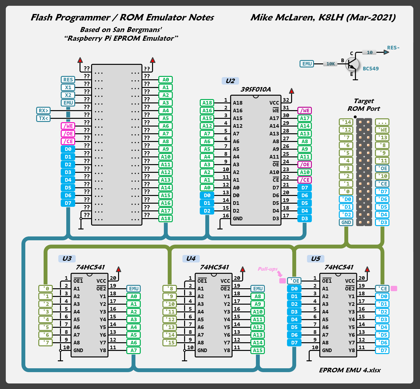

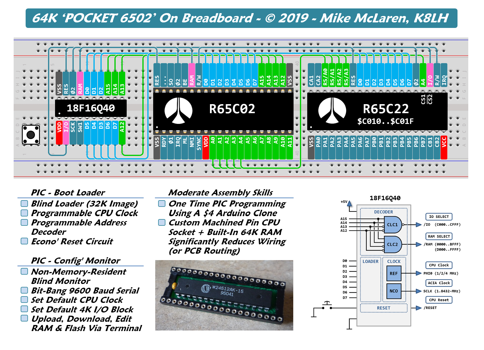

I'm reminded of San Bergmans' Raspberry Pi EPROM Emulator project where he isolates the ROM from the system while holding the reset line low during emulator programming mode. I thought about using a 40-pin uC instead of a Raspberry Pi but never started the project. Probably not very practical solution for your use case. Too many parts and you probably wouldn't want those three 74HC541's left in-circuit when switching back to normal 'run' mode operation.

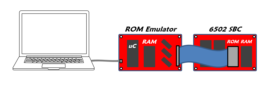

In the meantime, I played with the idea of using an MCU as a ROM, but decided in the end that the AVRs I'm used to probably don't have the oomph to meet the 65C02's timing requirements. I have started looking at an STM32 chip (specifically, the 250MHz STM32H523CE), but that's a whole new ecosystem for me, so I'm still on the early part of the learning curve with that.

Michael wrote:
One nice thing about using a PIC uC for the ROM image store is that the PIC can self-program its Flash memory so it's relatively easy to update the ROM image in-circuit (no programmer required).
It should be possible to accomplish the same thing with a 39SF0x0 flash device by harnessing the MPU to act as the programmer. There would be some code in the firmware that, when called, copies a flashing function into RAM, along with a suitable I/O driver, and then runs the function to read from a data link, e.g., a TIA-232 interface. The incoming data stream, following some sort of integrity check, would be written to the 39SF0x0.
