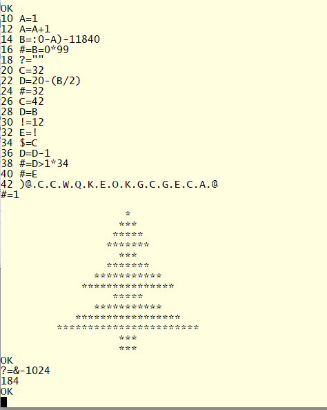

Back on topic, VTL-2 offers a non-portable way of READing embedded data with comments and out-of-bounds array accesses, e.g.:
